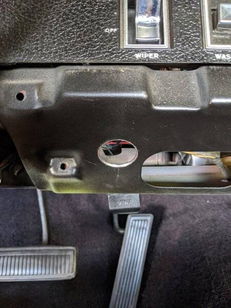

Hi everyone. I'm installing an air grabber on my 70 Roadrunner which is not an n96 car. I have the hole drilled, in what seems to be the factory location, and now I'm to the point where I need to drill the smaller holes to attach the switch to the metal dash.
I have not found any good reference as to which way the switch should be installed. I know there's an on and an off to this and I don't want to take a guess on drilling the holes for mounting.

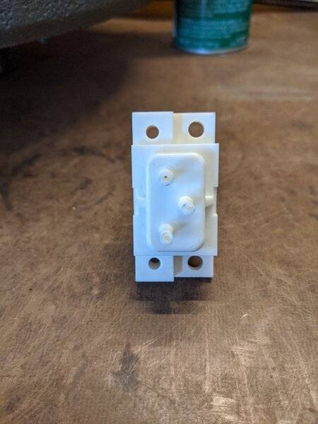

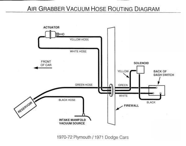

On the back of the switch there are three vacuum ports, the vacuum port closest to the outside of the switch is my guide. Does that go on the left or right hand side of the car? Based on the little drawing that I have,
I would guess that third port would be on the right hand side?

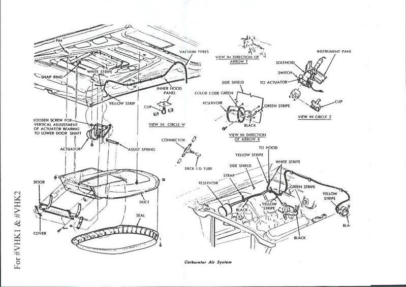

On the back of the switch there are three vacuum ports, the vacuum port closest to the outside of the switch is my guide. Does that go on the left or right hand side of the car? Based on the little drawing that I have,View attachment 1005935 View attachment 1005936 I would guess that third port would be on the right hand side?

Anyway, I have all of the components including the solenoid and the valve in the picture and dash is of my car. Like I said, I'm sure there's a certain way this valve is positioned in the dash as you have the three areas on the back of the valve to attach the hoses. My dilemma is drilling a couple of holes in the dash to attach the valve. I don't want to drill the holes and attach the valve to the metal dash only to find out it's upside down and now my holes are off. The holes in the valve to attach to the dash are slightly off from one another and different sizes. There's got to be a right way and a wrong way. Who knows, maybe I'm overthinking it. I guess if I'm wrong I could always enlarge or oblong the mounting holes in the valve.

Remember also, when installing the underhood air grabber hardware, that you will need a three (3) speed wiper motor to clear the air filter base. The three vacuum hoses connecting the valve, solenoid valve and vacuum resevour supply pass thru the firewall with a rubber grommet to seal. There is a bezel that should cover the screws. The FSM shows the correct orientation of all the components, including hose routing and vacuum connections. You will also need a manifold vacuum fitting.

Sorry, I get what you are looking for, does the single port go to the right or to the left. I will keep checking.
Yes that's exactly what I'm trying to figure out. But, if the image you posted is correct (the one with less detail) , shows the single port on the right hand side of the vehicle. That's what I'm going to go with.
Thanks guys, Bill
Just wondering if u ever solved this? Does the single port go on the right side of car?
I'm trying to remember but I believe that the port was on the right side. I guess you know once you plug it in and figure out if lifting up on the valve handle raises the scoop.

The drawing shown in #6 is a PICTORIAL representation of the hose routing of the vacuum lines. The PHYSICAL orientation of the Air Grabber VALVE.....left/right - up/down...is not as important as the correct connection of the hoses. Since the origional valve toggles up / down to operate (not side to side), UP for automatic operation places the single port of the valve and positions the valve body to the RIGHT.

Hey 6 bbl Bill. Regarding picture #1, any chance of getting the size of the hole drilled and measurements to its location?
Thanks.
