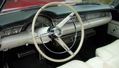

My 66-300 also has a white int. The ext. is red w/wht. top. Int. looks like this. 300_11.jpg

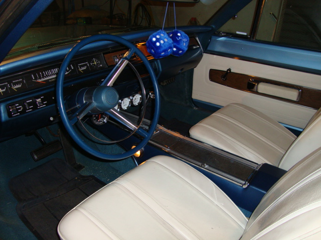

huh, weird. so did my interior get changed out at some point? it has blue carpet, blue dash pad and top and blue on the upper door trim. as far as i was told, it wasnt molested save for the console that got replaced.

yours looks correct..carpet & dash pad should be blue in your car

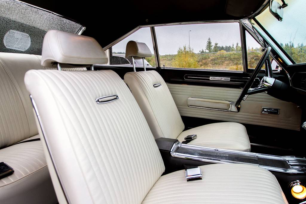

My '67 Coronet has White interior, seats, door trims. Would have had Black rubber mats. Console is black, dashpad is black. Headlining is Black.

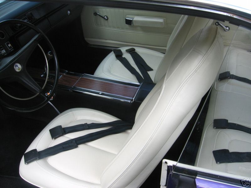

My 70 RR- White interior, seats, doorpanels, headliner, black dash.3794_3.JPG
