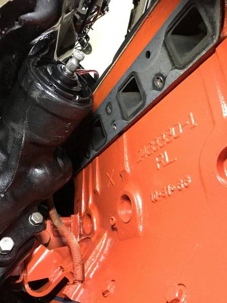

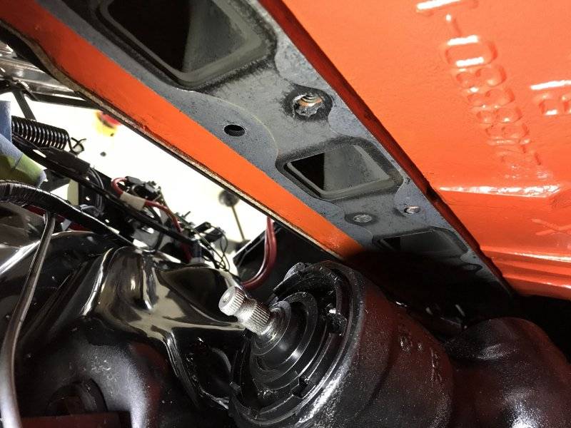

1966 car if it matters. The box is bolted in, steering column out, torsion bar out, starter out, exhaust hanging in place.
It was always tight getting a manifold off and on with a manual steering box. With the PS box in place it’s looking just near impossible. What’s the trick short of dropping the whole engine, k- member and transmission out?

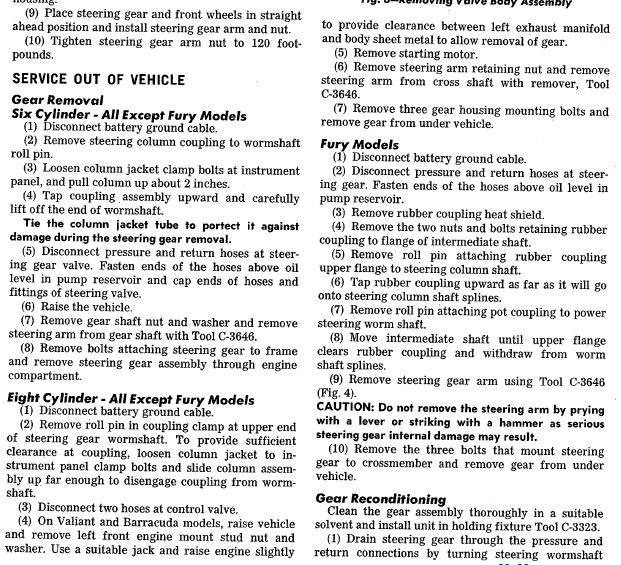

The manual calls for removing the box from the top by raising the left side of the engine. I put it in from underneath but I’m stumped on the manifold. There is literally only about 1-1/4” from the head to the lash adjustment screw.

left engine mount bolts out. lifted engine to roll slightly towards the pass side. Removed pwr str box out the top
Well at this stage, without having to backtrack a lot, it looks like my best approach is going to be to raise the left side of the motor up to gain space to slide the front part of the manifold in over the gear box and into place.

remove power steering pump and brackets, remove battery tray, jack up drivers side of engine just high enough to take it straight out from front
The manifold is in. The motor didn’t have to be rolled too far to the right. It wasn’t to bad once I realized there are 2 bolts on the left side motor mount instead of just the one through bolt. Lash screw clears by about 1/8”.
