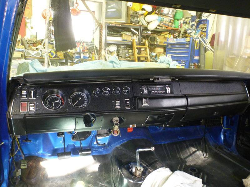

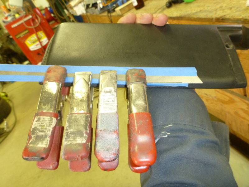

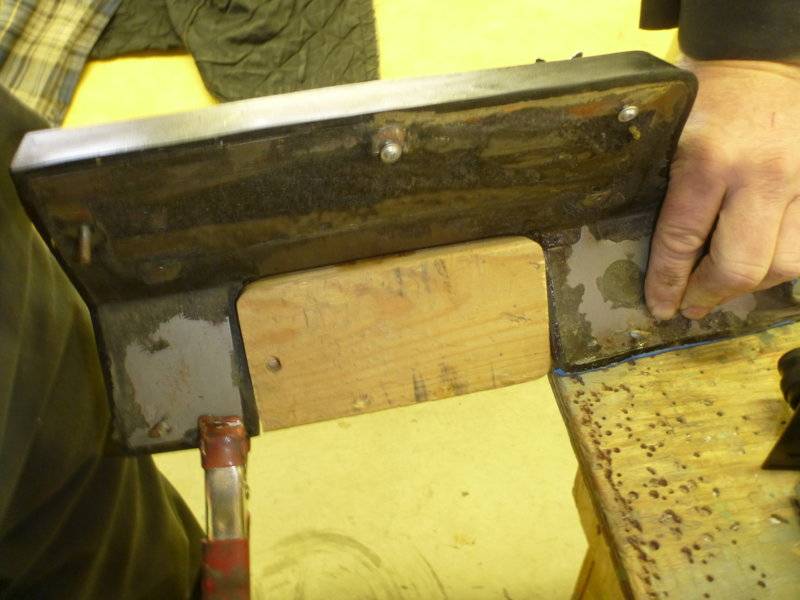

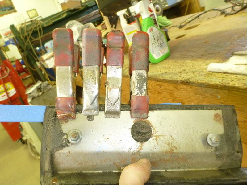

Pull'm back into place and re-glue them. Wood block shows how I got my ashtray area back into correct shape for proper gaps around the tray.
