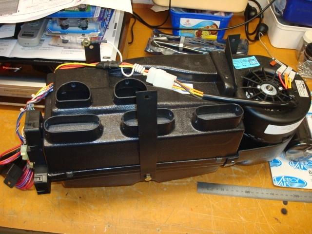

Who's the manufacture of this A/C unit ?

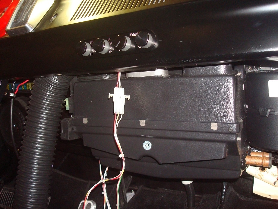

I have a 1970 gtx my dad had this unit put in car about 10 years ago , he got it at a car show in Ga well he don't know who he got it from or name brand . Paid a guy to install. Well Iv been working on car rewired and moved the ac heater hoses from under wheel well too under hood I put in new dash harness lights gauges ect. Well now time wire the ac unit back up. And I don't have clue was looking for name brand so I could get the wiring lay out. There s no name anywhere I can find. Have any of y'all seen a unit like this ?thanks image.jpg

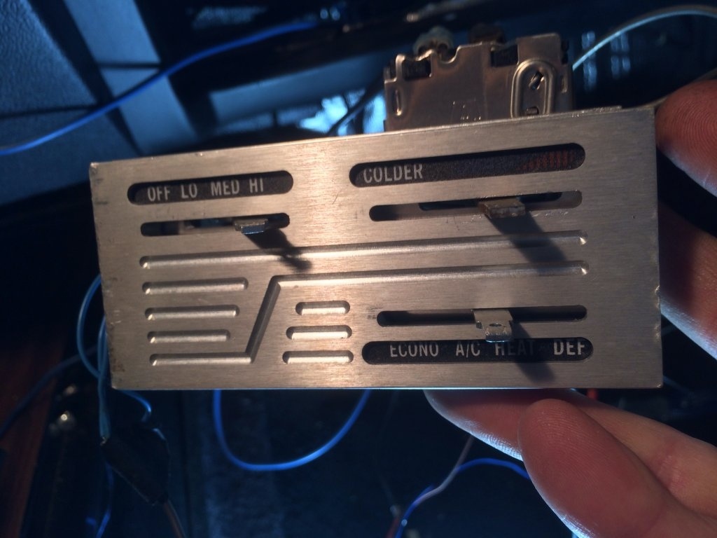

Maybe I'm looking for wrong thing mayb I need general a/c wire diagram. ? Also the switchs in this unit I don't like , can I used switchs from a nother manufacture. ?
Old Air, Vintage Air, Classic Auto Air, and Nostalgic AC Parts are the ones I know. That control panel may be succeeded now. Search around the above names and you may find something that works.

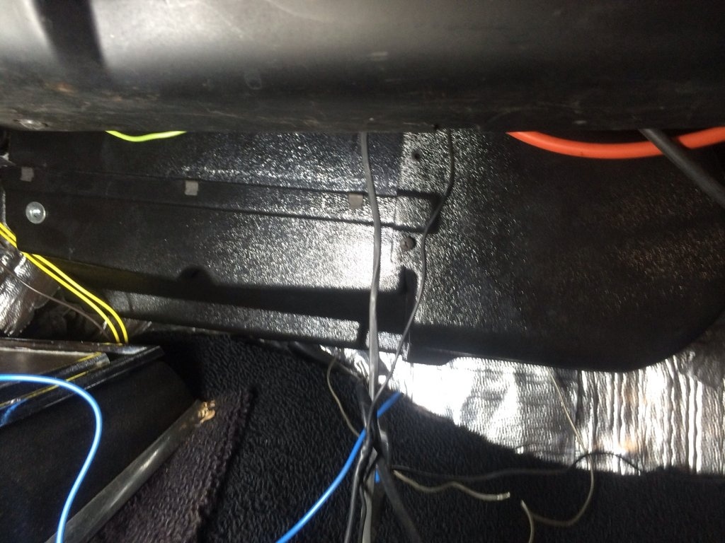

Thanks grabber ya the kit is old. I'm guess they all work about same ? I can't get blower motor running got power to motor but can t find ground. When I rewires the car the ac was sliced in , wires with just black tape. Dam mess just a ball of wires. But my fad said it worked at one time.
Thanks grabber ya the kit is old. I'm guess they all work about same ? I can't get blower motor running got power to motor but can t find ground. When I rewires the car the ac was sliced in , wires with just black tape. Dam mess just a ball of wires. But my dad said it worked at one time.
That under dash unit looks like the same clips and plastic housing as my Vintage Air unit in the A100.
That looks like it ,, thanks now all I need to do is see if I can get the right control switchs KiwiGtx. I have same plug the one going to motor but I don't have the white ground wire hummmm. Mite be my trouble ? Thanks
Running the exact controller as shown by kiwigtx, has a nice nostalgic look in the car instead of the bing, bing, billet stuff. I agree, looks like my Vintage box from what little bit I can see.

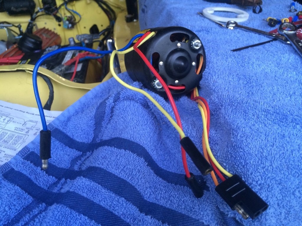

This is the blower motor. It is blowing my mind. The 3wires at the plug go to the switch low M high each wire gets hot a each speed. The other three , two of them where pluged together and the thirt wire went to vacuum valves where is ground ? Motor don't ground thur case ? Everything is plastic. I lost
