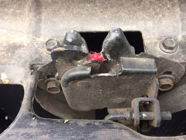

My car has a regular latch (and hood pins) but the latch does not catch the hood striker. The latch will work if i can get the striker to reach it, and the release works too.
The latch is moved as high as it will go. Maybe i need a different striker ? Is there one that stands farther off the hood ?
I used some grease to see how close i am to catching, and you can see it touches the catch, but not enough to capture it.

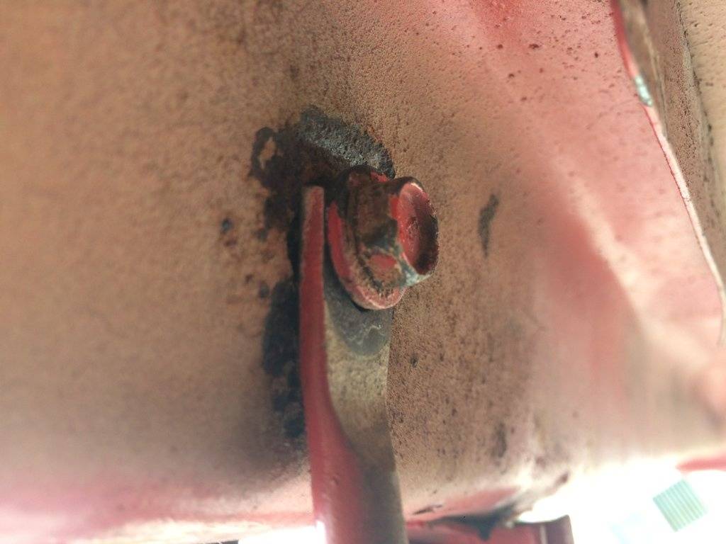

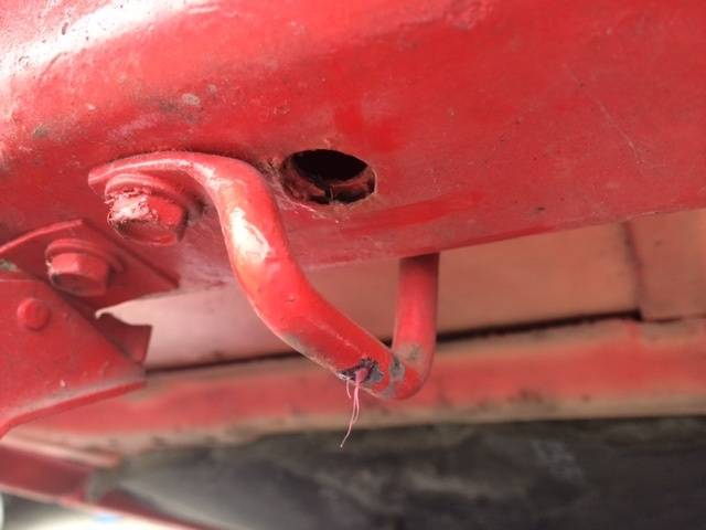

Crisis overted. Took the striker off, and slotted the bolt hole on the vertical end so I could space it down.
Started with 3/16" spacer (which worked) and started to thin the spacer each time. Ended up with zero spacer but with the vertical mount slid down. (See pic) at that point the hood was still too high in the center which allowed me to move the latch back down slightly and get the hood smooth with the nose.
Guess it was all in the angle of the dangle. :)
