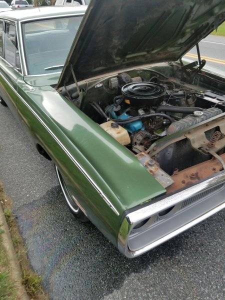

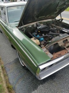

its been a while since my last post cause everything's been going great. But today I had a wild ride. I was at a light and turned left and heard a loud bang and suddenly the gas was on the floor and the tires were spinning. The car was flying down the road while I was trying to keep control, I was close to a shop I know of and tried to get it there but there was a redlight so I had to yank out the key (thinking back I could've thrown it in neutral) and another loud bang when the hose to the radiator and intake blew up. Smoke from antifreeze was everywhere. Luckily everything seems fine. Just the cable and the hose. Luckily I did the brakes last week.

Sounds like a broken motor mount. The engine raises up pulling on the throttle cable sending the peddle to the floor. Neutral or turn the key off is the only way to get it under control.

That must've been crazy! But I'm pretty sure the cable was just old, and my mechanic who's shop was across the street said he thought it was the cable? Who knows I'm sure I'll find out soon. Thanks for the advice!

Please check the mount, especially the driver side.

For a few months, my throttle would stick if I went over 1/2 throttle. I thought the cable was bad so I replaced it but the problem persisted. It would always unjam if I did a quick foot-to-floor of the pedal. It turned out to be a part of the choke linkage that I did not remove when I removed the choke plate.
You should NEVER drive these Cars without a second throttle return spring.
