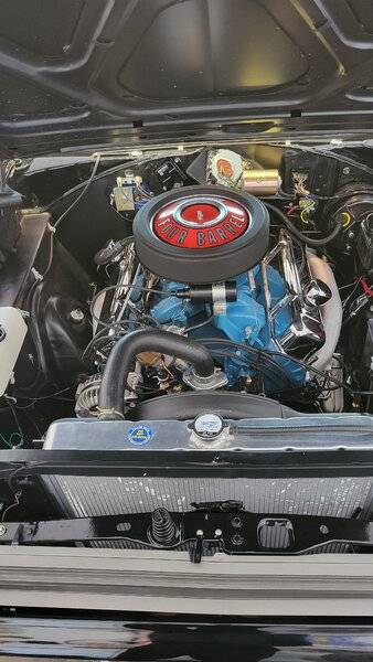

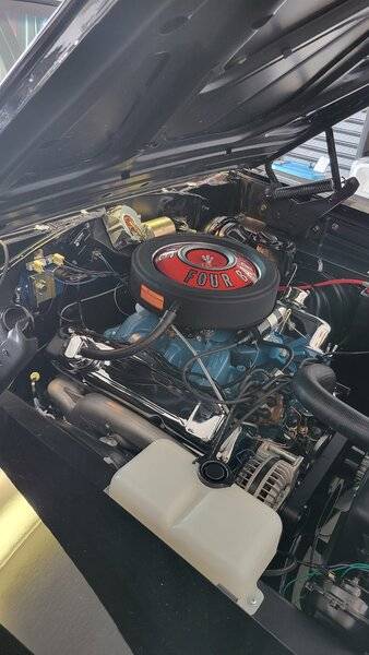

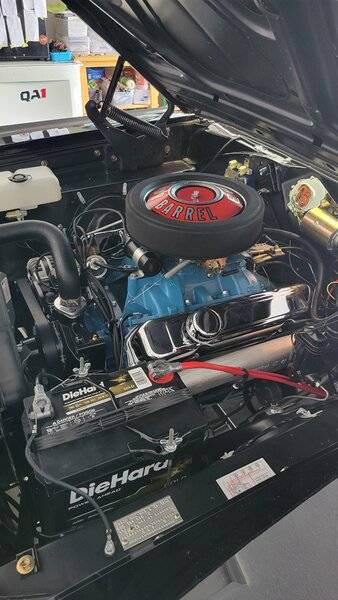

My 383, formerly 318 car, yes it's a 4 door sedan.
