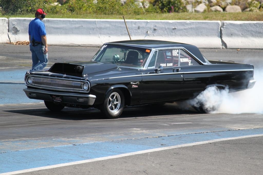

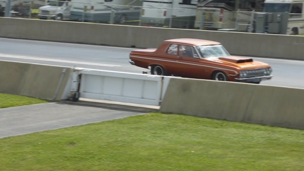

I only run 4 pins on my 64 Belvedere. 5" Hemi scoop. Car runs right around 150. It does flex up at the sides, probably should have 6. Compare the hood pic towards the end of the track (look at the sides) and the pic in the
burnout.

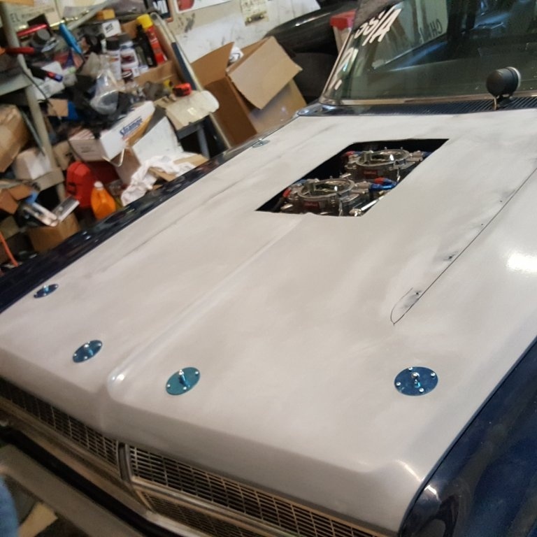

And heres my new hood. Ready for paint.

View attachment 332974 I only run 4 pins on my 64 Belvedere. 5" Hemi scoop. Car runs right around 150. It does flex up at the sides, probably should have 6. Compare the hood pic towards the end of the track (look at the sides) and the pic in the
burnout.
Doug

My old car had Dzus. I got to thinking if the hood has to come off fast, how will that happen? Besides the pins look old school and that was the look I was shooting for. I agree about mounting them forward of the core support. Mine are. Look at the pic of the hood at speed,the nose isn't moving at close to 150.
Doug
