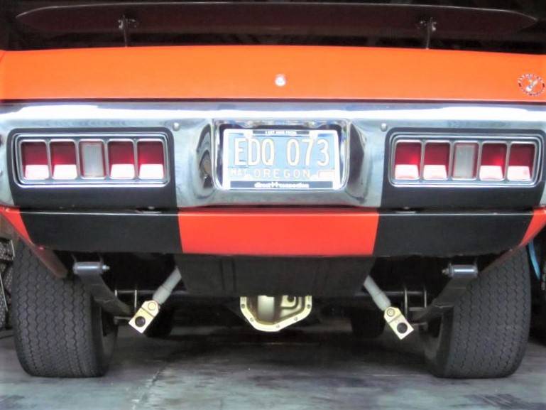

Will a 70 Dana 60-Bbody, fit a factory 71 Bee stock mounted?
I have a '68 Dana in my '71 Road runner. I did the MP e-body offset hangers and shackles and welded the spring seats on to match.
Would like members previous experience with these swaps
