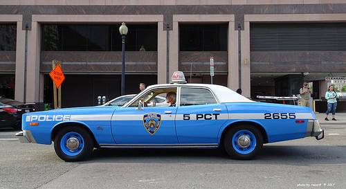

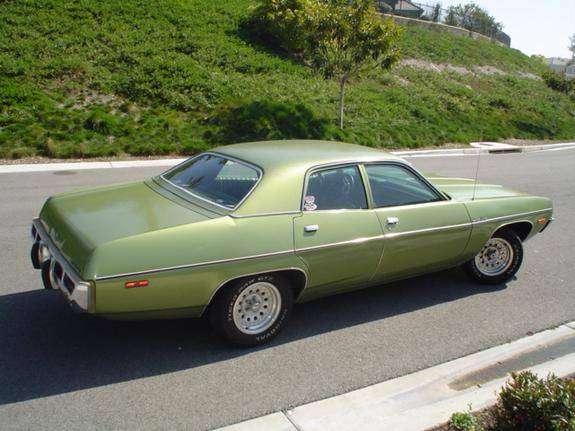

I'm thinking that they will except that the crease on the lower part of the rear doors may not match up with the crease on the rear quarters of the 77. Looks close but you'd have to actually measure them or bolt them on and try.
Look at the jog on the rear door jamb, it's different. I do have to wonder if the fronts interchange though.
Starting in 75, the B body sedans shared one body, based on the Dodge styling. 73 Dodge doors may fit but not 73 Plymouth.
