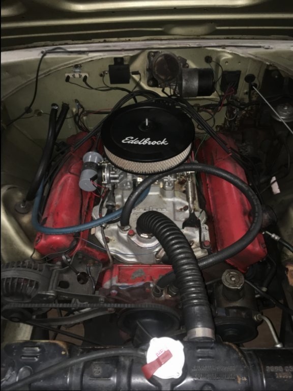

I have a great running Poly 318 in my '66 Charger. Going to pull it soon to install a 440. Would sell it to you when I pull it. Would even let you come try it out before I pull it. It has been upgraded to a 4bbl intake and carb, and gets great mileage. Runs as good as any modern 318 and would bolt right in

Would include air cleaner, carb(edelbrock 600 cfm), alt & bracket, power steering pump and bracket all pulleys, belts, ignition, and exhaust manifolds for $850. It will bolt right up to your car and would save you the headache of tracking everything down. Will even throw in an extra poly and 727.
The one pictured doesn't burn any oil, doesn't run hot, and starts as good as any fuel injected engine

It's still In the car If you want to test drive it. I think I can pull it out, with your help in a couple of hours.
