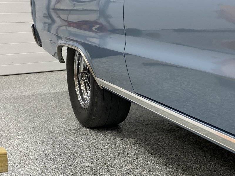

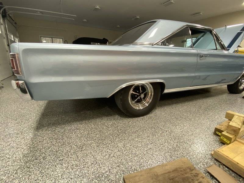

Looking at picking up a set rear tires so I can move the car around, and put it on the road for a little testing/shake down, 66 Coronet with 10" slicks on it right now. I live in a rural area and have to travel about a mile to get to the black-top. So, I'm eye balling a set of 255/60R15 to put on a set of steel wheels, pretty sure the tires will fit but my question is backspacing on the wheels. From what I've found/read so far 4.5" back space would work just fine, my steelies have 4.25" back space. Think that will cause an issue with the edge of the wheel well opening?

OK, my bad just went out to confirm what I have. I was wrong! :realcrazy: 28.0/9.0/15 slicks. So, 255/60R15's are out, I'll go with 245's.

Just did this a few days ago. 255-60-15 on a 7” rim with 4.25” back spacing. Works fine.
This is with standard replacement rear springs - no lift.
....and your 8" wheel with 4.25 backspace moves everything in bsb's example a full inch closer to the fender.
Does it look like there's an extra inch of room there?
Exactly!
And the tire cross section gets a 1/2” wider on an 8” rim. So it could be more than an inch.
The inner fender on my X runs parallel to the contour of the tire side wall. I don’t have much more than 1/2” clearance. I worked the suspense pretty hard with two of us in the car and nothing rubbed. 4 people in the car, maybe it would.
My tires are the MT ET Street Rs. They might be just a little bigger than some other P255-60s.

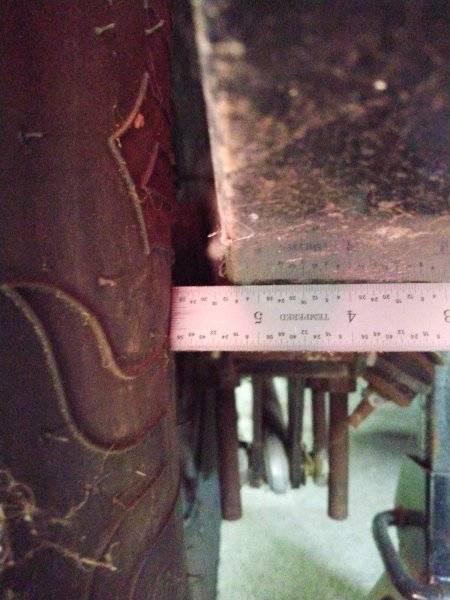

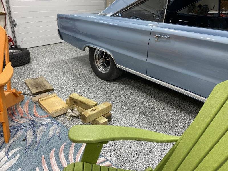

OK, correct me if I'm wrong, this may be a "caveman" way of evaluating it. Theoretically, I should be able to take the slicks off, with the rear axle on jack stands at normal ride height, use a framing square laid against the brake drum, and measure out to the inner edge of the wheel well opening? There by giving me the max distance I have from (wheel to drum) mounting surface to the wheel well edge? This will allow me to calculate the needed back space to get that 255 tire in there?
Your 9" slick is probably bigger than a 255. Pull the slick off, measure the backspace , and duplicate it on the new rims.
Or just pull the slicks off and put your 255s on.
Edit: 255/60x15s are about 3/4" shorter, and slightly narrower (in tread width) than your 9x28 slicks.
Set two squares on the floor, one one each side of the slick to measure the cross section width including the sidewalls - close to 11" or 279 mm, think I'll be OK with the 255's. Going to pull one of the slicks off and measure the B/S, it's got more space on inside than outside, so I'll order the wheels with the B/S accordingly. Thanks guys! :thumbsup:
