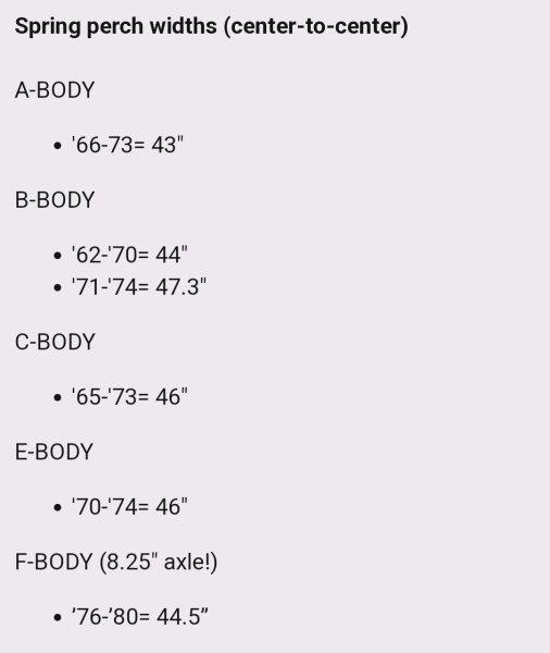

I'm wondering if either of these rear ends would drop in to my 73 Satellite. It currently has a 8 1/4. I want to pick up an 8 3/4 that I can install a suregrip and regear then drop in for simplicity. I'm just confused by what years fit what, etc. No affiliation with these craigslist posts, just something I ran across. They are the only two b body rear ends I can find anywhere near me.

Short answer...No

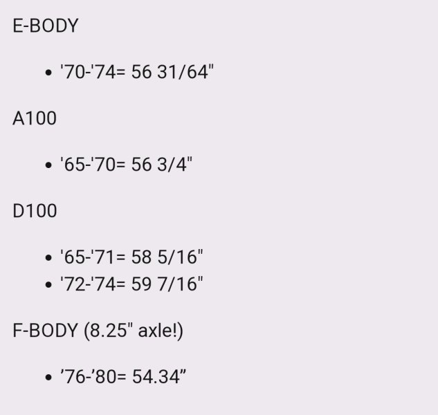

Spring perches are out wider on a 73,drum to drum is also wider, also has a isolated spring in 73 (I think). Definitely some work to make it work and not a bolt in.
A good candidate donor that can be found cheap is out of a 70-71 c body.
