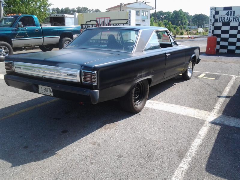

The biggest i could get under my 66 plymouth and i even trimmed the inner wheel lip off some was a 275/60/15 which is whats on there now.
