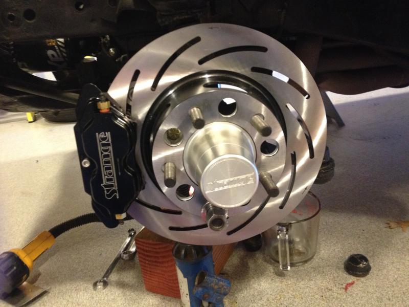

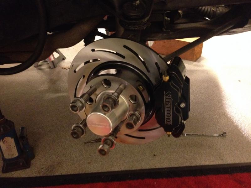

I have a 4 wheel set of Strange Engineering disc brake conversions showing up here Monday. I have heard these are good. amazing the weight difference from drum to disc. the weight for my fronts each 49 lbs =98 versus the Strange setup for both is 33lbs front and 24lbs for the rear set.

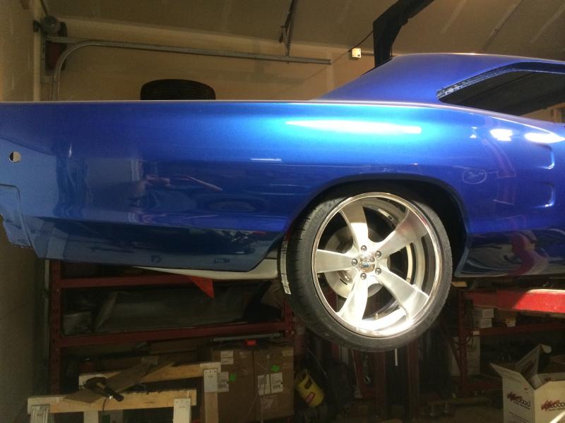

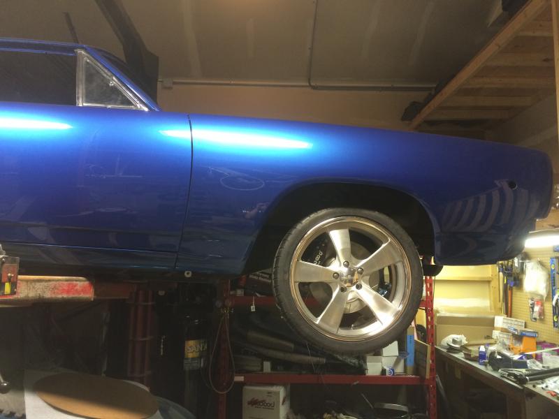

Here is mine with 19" wheels 13" brake up front and 20" wheels with 12.19 in rear for an idea.

2014-12-24 11.09.59.jpgMy new front disc brakes. from 98 lbs to 33 lbs
