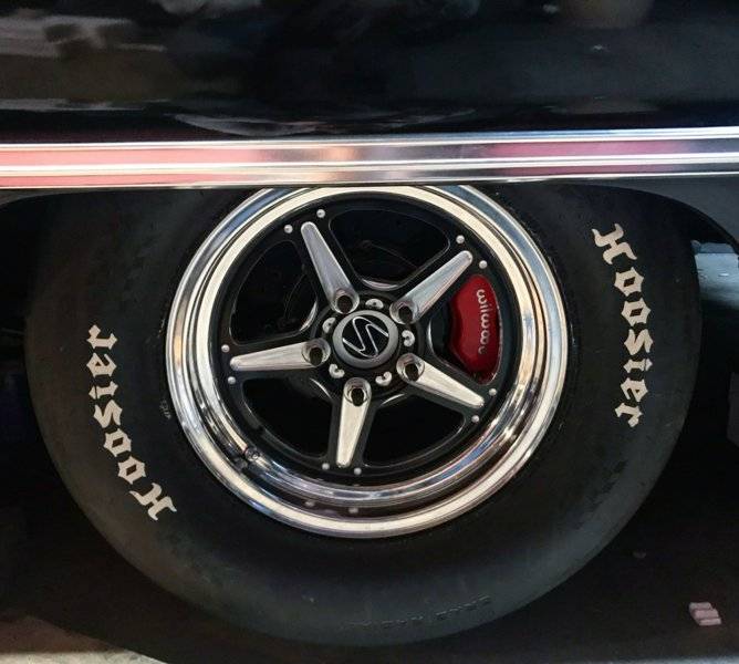

Here’s my 15” street lites with 12.19” rotors
Wow! That's tight. Nice job!
