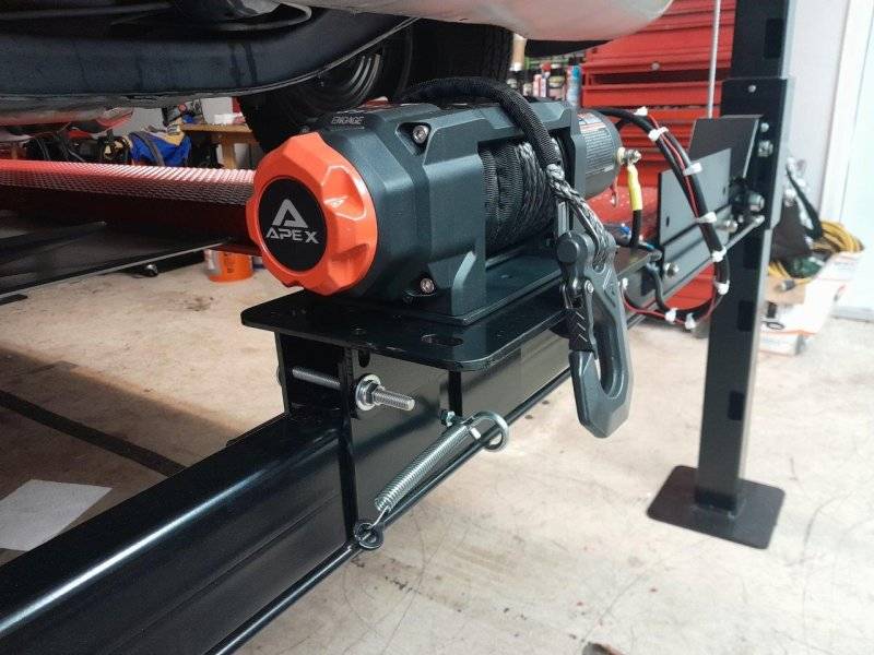

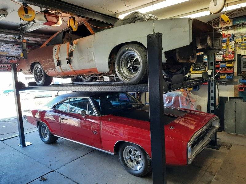

The one I got was made by Advantage Lifts/Backyard Buddy, it's a new product and assembled perfectly, I added some pics.
Here's the link, on sale for $149 and free shipping (it's 26 pounds): Universal Winch Mounting Plate for 4-Post Lifts
All the compatible winches ae on the page as well. I went with an APEX BADLAND 5500 long drum ($259 on sale, good reviews) 100 foot of synthetic cable) and bought the APEX wireless remote ($39 on sale) that works with it. I work alone and no one is readily able to assist me, so I'm making the lift old guy ready.
Chuck (snook)
I need to get me that. I work alone as well. I once had to use a come along to pull a non-running car onto my lift. do you use a spare battery to power the winch? does anyone make a 120 volt a/c winch?
One has to wonder though if not anchored down would the hoist slip or slide on the concrete trying to pull the car up the driveway to hoist?
