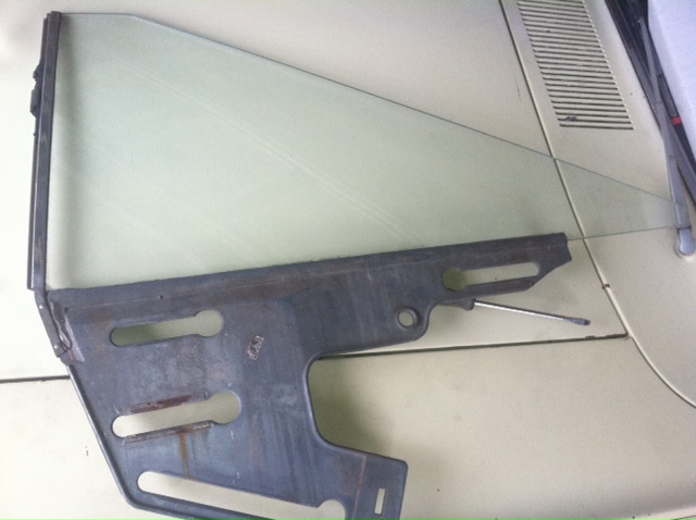

what do the go to, purchased them for my 67 Belevdere, but they are different,
looks correct for 66-67 bel or coronet 2 dr hardtop. What is different on yours?

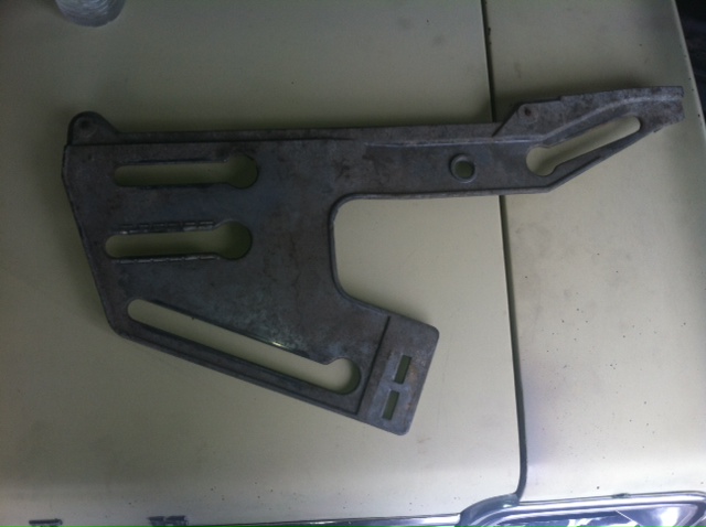

One, will not fit, or maybe I dont have the angle right. Attached is the picture of the one removed.

It may be the wrong side & curved in the wrong direction
67 pictured is a left, driver. missing lower steel 'stop' bracket also. attached to slot rectangle shape areas
Ok, I have the left and the right side for the 1966 version pictured. I have all the brackets and such for the 1967 broken one posted. The problem is when I try and put the glass (1966) part in, it is very tight and I'm worried about one breaking it, or two getting it in and realizing it will not work. Then I will need to get it out some how, and it ain't going to be real easy. So, does anyone know if the 1966 part will work or should I simply wait and find a 1967 piece of glass?
think you will need to wait for the glass. Alternative, and Im not suggesting it, would be to change all the 66 regulators to the 67 to make it function. The geometry of the arms to the glass mount are your issue.
Is it clear or tint glass you need? and to be certain, it is the left Qt you need, only!
chignikred - clear and the drivers side
Thank you! What I was thinking too, but wanted someone with more experience to set me straight
