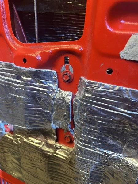

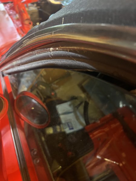

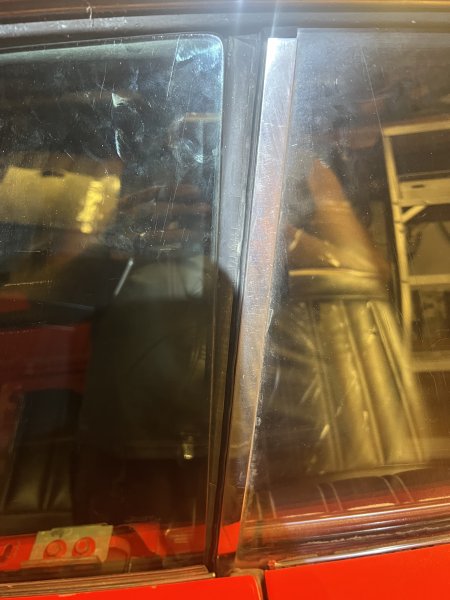

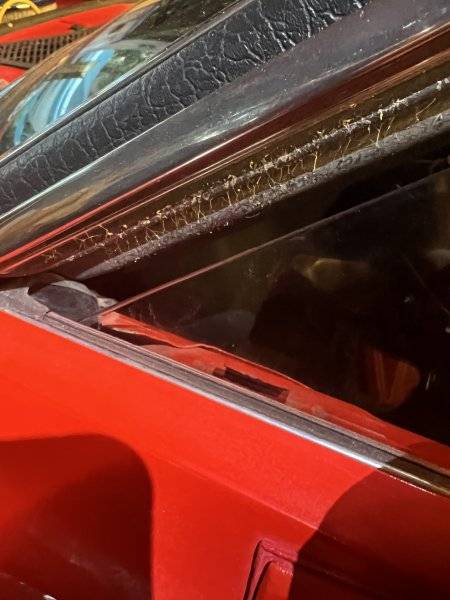

Hey all. I have 72 satellite hardtop two door. Have the body shop manual. Tried all different ways. Original equipment with new felt and stoppers etc
Cannot for the life of me get the front of window to seal without being too far up in rear of window. Adjustment bolts as far down as they can go. Any suggestions?
It’s like the entire window needs to move forward and then tilt more.
Uggg stupid. Finally figured it out. I had the pivot adjustment bracket upside down!!
