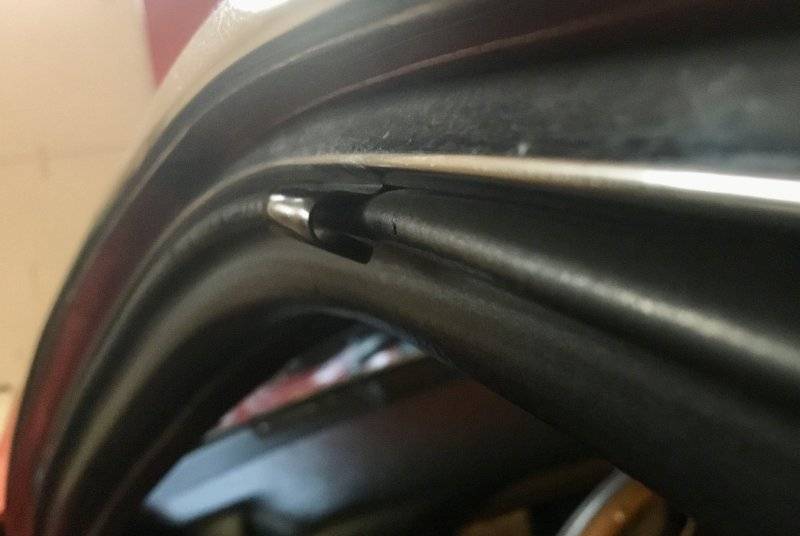

71 B-body. Does the curve part goes toward the window or inside? I think the glass rests on the curve? And it is placed just after the curve of the body?
Also, does it go on before the trim or after?
Thanks!
rrTor-Red - See attached pics for the installed direction and measuremt. I replaced to clip with the trim and window seal on the car.

View attachment 1413396View attachment 1413393
Thanks Ronnman! So I guess I had it wrong. I have to pull the weatherstrip down to install, correct?
The car was taken apart years ago, so the memory isn't as good . Trying to get the interior trim together too along windshield and windows. Frustrating.
I called it the window seal. Yes, you need to pull it down to install. If I recall correctly there will be two screw holes there.
