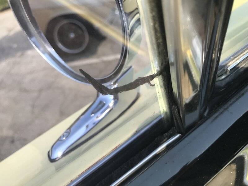

She this is why the window binds. Where to source this item?
Top Cat cat wiskers. Most all vendors carry them.Vans, Detroit Muscle and the like.

That's not your "Whiskers" Dennis, that'd be your vent pillar track mylar falling apart. Lots of threads about it and no source of good OEM mylars anymore. You'll have to buy the repops and trim their outer lip off of to make them work okay... and use your old slider clips, the new ones are moulded wrong. Door panel off, window has to come out. Easiest on the bench with the complete vent window frame as an assembly, but you can pull the door glass out by removing the rubber stop block, up stop removed and window crank regulator slipped out of the track.

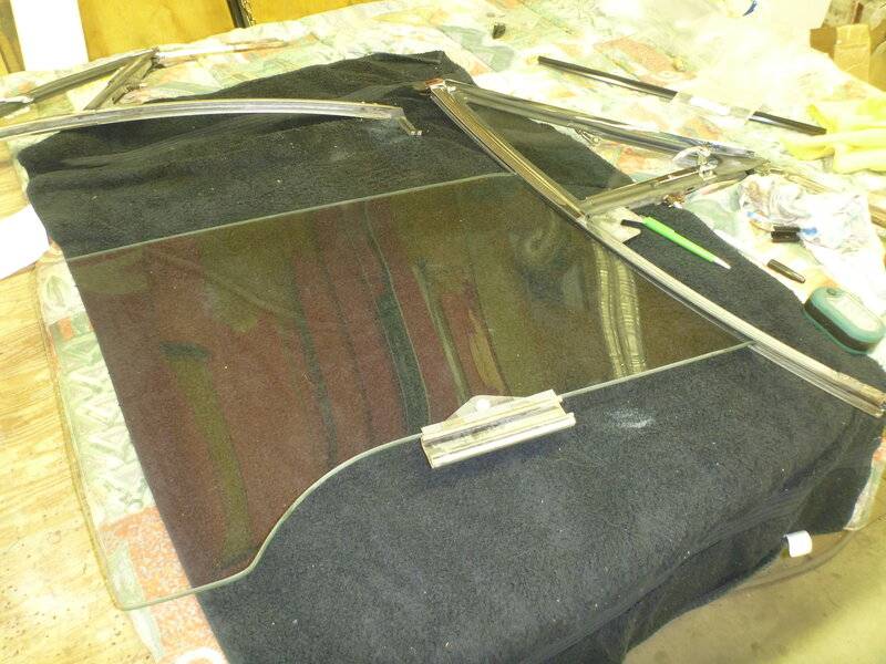

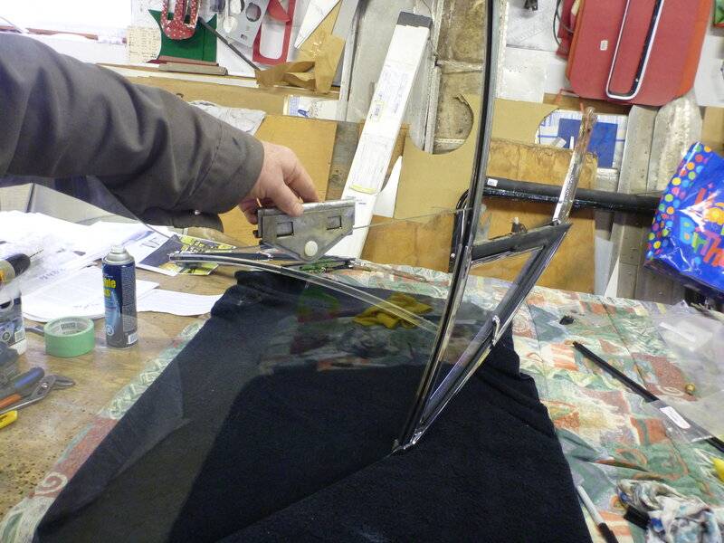

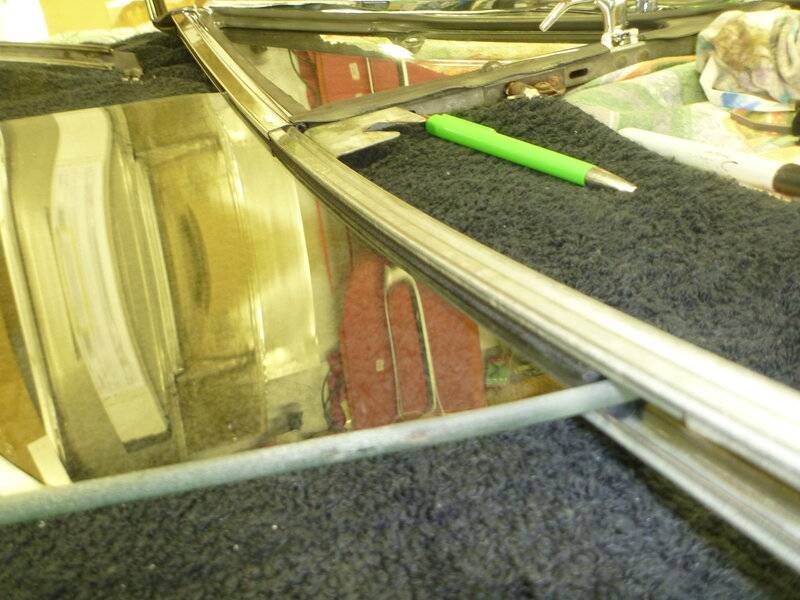

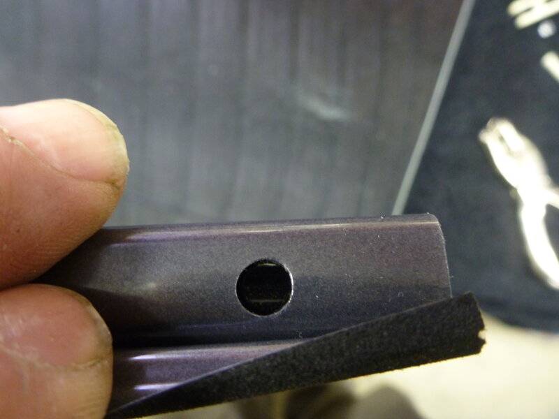

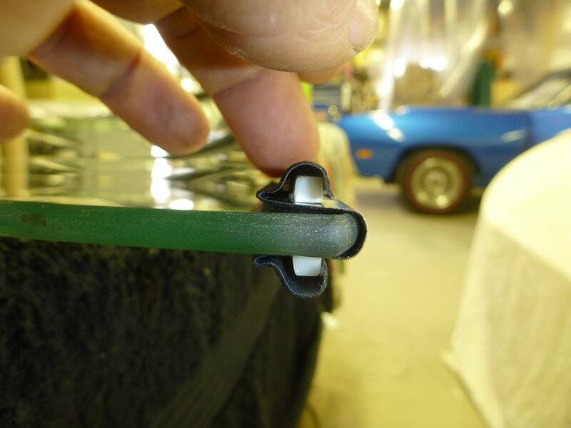

And when I put in the new whiskers, I did this with the glass out - well had car torn apart anyway. Found some of the damn retainer clips for those new ones wouldn't set right so was good to have the glass out to get better access to set them in place.
If i"m seeing the picture correctly, you need to replace the felt inside the vent window frame. I don't think that can be done on the car so the frame has to come out; after removing the door glass and regulator.
On my Coronet the doors were gutted during the resto so I was able to replace all the window felts with the door off the car and the vent frame on the bench. If you decide to move forward, might as well replace the door felts too since the glass will be out.
