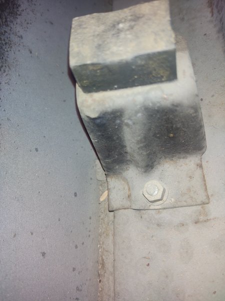

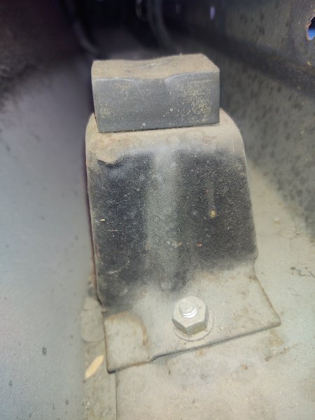

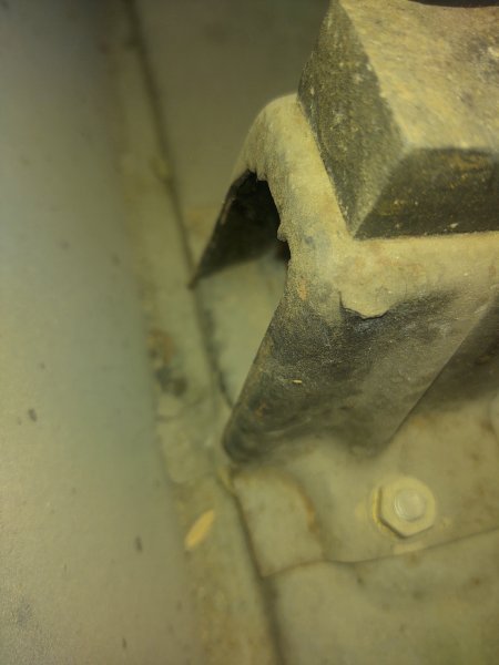

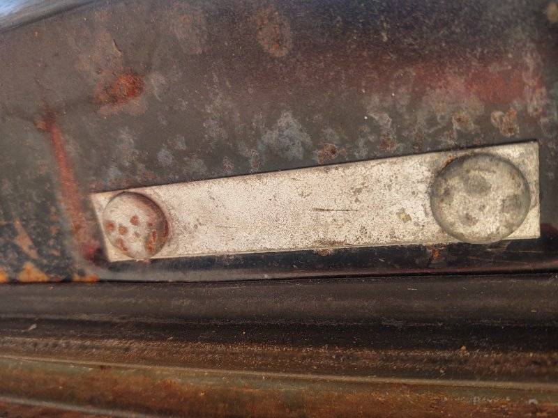

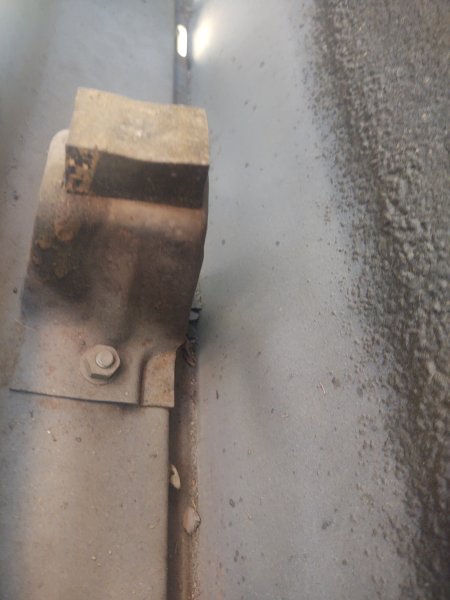

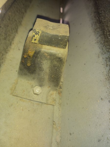

I have factory power windows in my '70 Charger and it has the big bracket and rubber stop as you described. Below were taken of my driver's door.

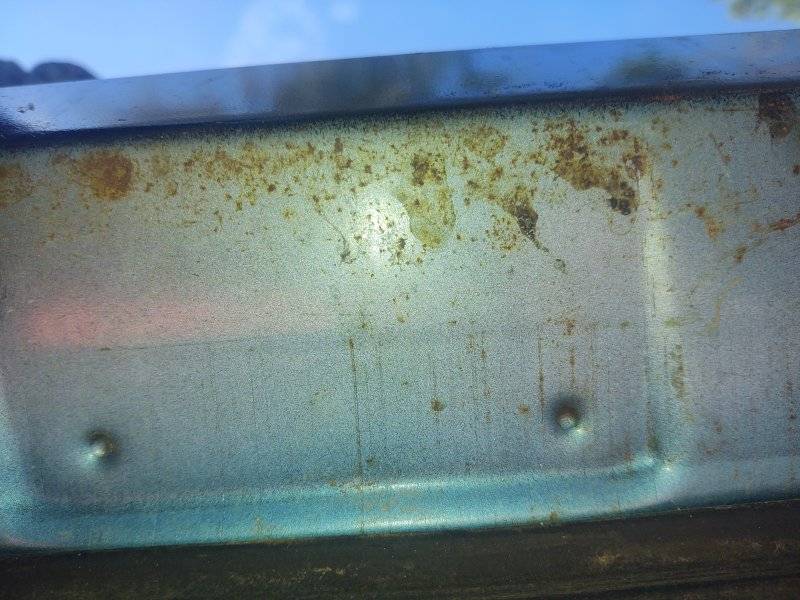

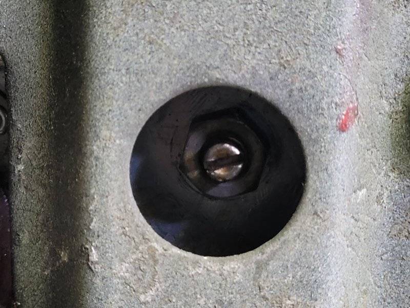

Below is the bottom side of my '70 Charger driver's door showing the plate with the two threaded studs for mounting the big bracket shown above.

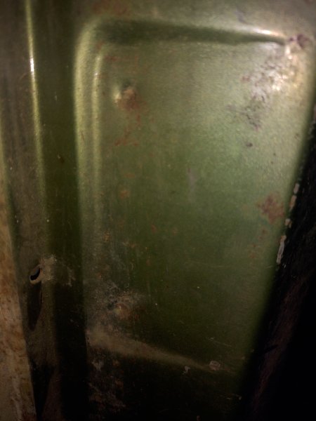

Below is the bottom side of a '68 Charger passenger door without power windows. Note the dimples for locating the holes needed for mounting the plate with threaded studs.
Below is the bottom side of a '70 Charger passenger door without power windows. Same dimples/locations as the '68 passenger door above.
DeltaV !!! THANK YOU ! - You nailed it right on the head ! (LOVE THE PICS) I DID convert to power windows and there is no way to stop them from bottoming out. Your PICS show it all. NOW - instead of "reinventing the wheel"...where can I acquire these from???

I added power windows to my '67 R/T, and had the same problem with front window down stop. My solution is kind of crude and is definitely not factory. I drilled out the two embossments in the door bottoms. I then placed a length of 2x4 wood in the bottom of the door, and screwed it in place through the holes in the door bottom. Like I said, kind of crude but the right height, and it has worked for the past 30+ years. Who is going to see it anyways?
