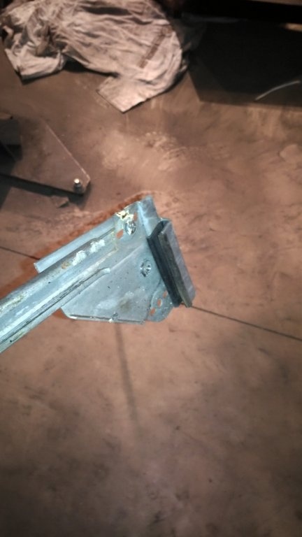

There seems to be some sort of fuzzy/weather strip where the window sits in the regulator. Its U Shaped. Is there repo available for this?
i took a picture thats part of the regulator
Not knowing exactly what I am looking at, do you possibly have a picture of the regulator with the flocking or channel, even if it is just some pieces of the material. We stock most of the available pieces to repair a regulator, but I can only think that it would be something like glass setting tape. Some used a piece of material like a stiff gasket material. Is the regulator on the other side in better shape and offer a better view of the piece?

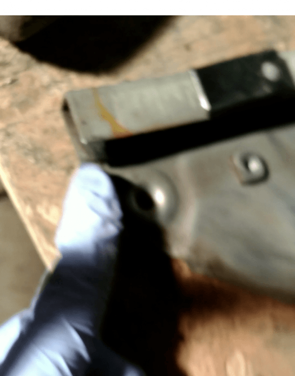

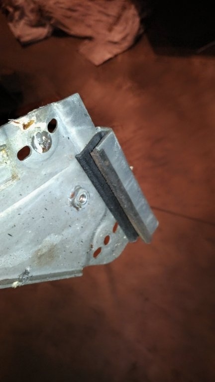

here is a better picture :)
this one is ok but my other one came out in pieces so id like to replace them all

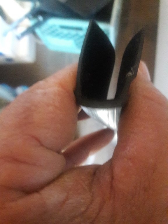

If you can lay a tape measure down so that I am able to make out the dimensions of the channel, then there is a good chance that we can provide a very close piece to fit your needs. Glass channel usually runs either in a 1/8 or 1/4 inch thick glass, but the height and width of the base makes a difference. The linear length is not an issue as most of it comes on rolls from 100 to 500 feet to a roll, you just cut to the desired length.
ok i measure the width of channel it needs to be a less than 1/2 inch and the less than 3/4 inch

Hmm i took a closer measurement and its actually 3/4 from bottom to top. 5/8 wont overlap so this means some metal will be exposed
do you have anything with 3/4 height? a little over 3/4 is also ok. 7/16 is good to test for width

Let me do some more checking into this. So you are telling me that the height is 3/4" tall from the base of the channel to the top and the channel is 7/16" wide at the base. I am assuming that this is a flocked rubber piece.
sorry i dont know what flocked rubber piece? one side is like suede kinda
yep from the base to edge of top is 3/4 and channel width 7/16
Weatherstripping flocking is known as small fibers of fabric is impregnated into a rubber extrusion. This process became common starting in 1963 with the Mopar weatherstripping and allows items like the door glass to slide with less effort between two opposing surfaces. If you can imagine your door glass sliding on a wet piece of rubber, it tends to want to adhere itself. With the flocking, it slides better.
