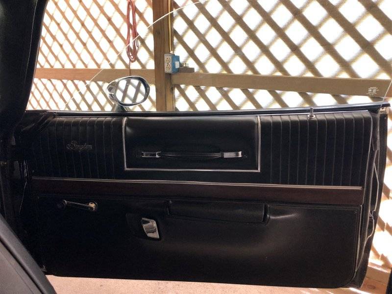

I finished getting the passenger side door panels installed today. Slow but sure we're getting there!!

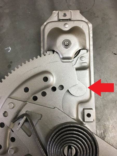

Seems dumb to have to set the "up" limit on anything but a ragtop !!
Anyhow, here's what I was referring to. The one in the first photo is a cam - adjusted by the screw in the second photo

Photos are '69 Plymouth B-body. I realize the vehicle difference, just pointing out the workings of the mechanisms.
