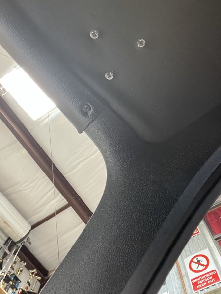

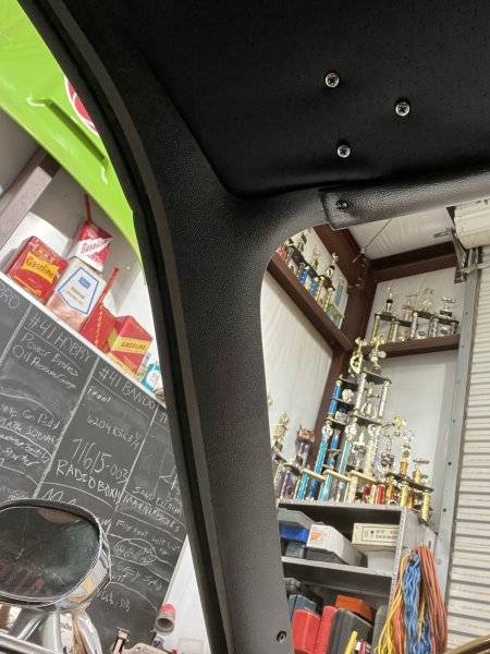

Hi all! I am ready to glue in the new windshield for my ‘74 Charger. Is it something a few handy amateurs can manage, or should I hire someone? I have the a-pillar molding in as well as the molding that goes along the front. Is it better to glue in the glass with those in or out? Thanks in advance for any advice!
It's easy to do with a helper. Inside moldings shouldn't bother it, but may be better in case the butyl tape ones out.
Oh man….if all my cars were as easy as the 71-74 B and all the E bodies, I’d never need a professional.
All my cars use windshield gaskets up front. Those do take some skill and patience. Cars like yours are easier for certain.
Good luck.
