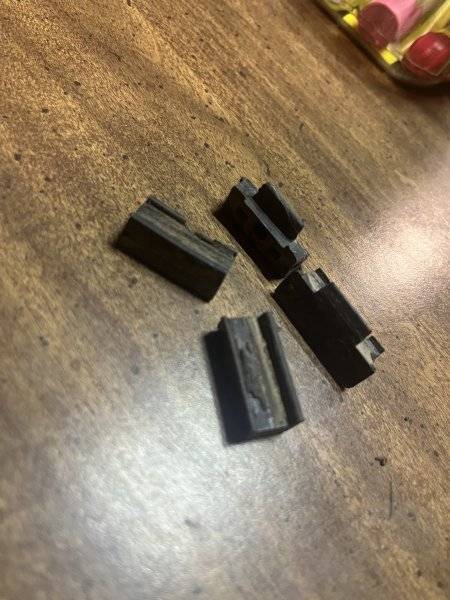

Hi everyone! I am having my windshield and rear glass installed this week in my ‘74 Charger! I have the original setting blocks, but I can’t remember their placement in the car. How many should I have? Does the rear glass have them too? I’m posting a picture of the pieces I labeled as windshield setting blocks years ago when I removed the glass. Does anyone have any pictures I can use as a reference? Thank you!
Butyl is soft, without blocks the window will slowly move down. Not familiar with your car, but look for stamping depressions at the bottom of the glass or look for notches on the underside of the trim that allow the trim to be but over the blocks.

Thank you! I will do that!
