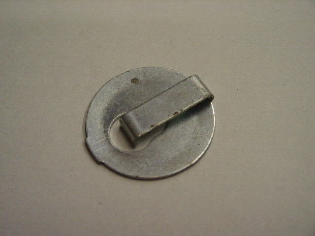

Here is a picture of a similar transmission arm.
You can see at the end of the arm where it is supposed to connect to the motor pivot arm, there needs to be some kind of bushing or reducer to fit on the pivot arm pin which is a smaller diameter. I need to know what that bushing thing is called so I can search for one to buy. Or better yet, if anyone has an extra one for sale......

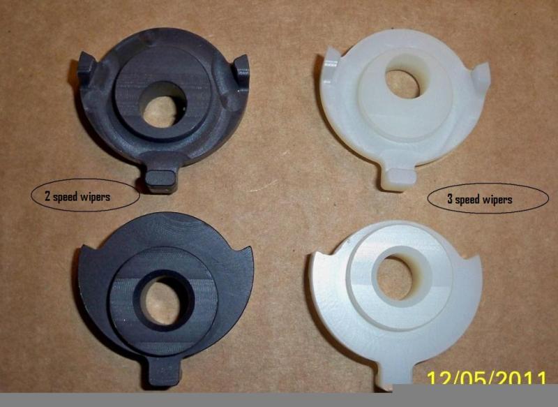

Year one has them for I think $4, then I found one on Ebay for $2...Y.O. is probably your best bet if you have issues dealing with Ebayers. HTH.
There is both a 2 speed and a 3 speed set in ebay now. $4 dollars would be cheep i paid almost $40 for mine but it was complete arm and all. I think the year one ones were prety pricy also if i remember.
Thanks to you Propwash I found out what the missing piece looks like, went through the random parts that I have for the car and FOUND THE PIECE!! Got the system back together and it WORKS!!! YOU are the MAN! :headbang: Thanks again! -Shag
