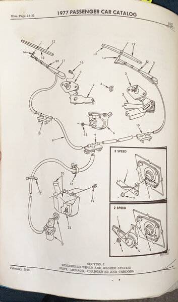

Hey guys anyone have a pic or diagram for a 79 cordoba 300 wiper system my wipers were not working and found that the arm and bushings were gone but the motor was spinning and found a few parts in the trunk and have no clue how to put it back together or if I have all the parts I need Any thoughts? Thanks

Maybe this diagram will help
