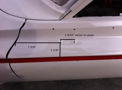

Hi, have ordered left & right side wing mirrors for my 63 which originally came with no mirrors. Is anyone able to provide measurements and/or photo of correct factory mirror placement on doors before I start drilling? Thanks.

OK i went and looked at the car. here is a photo of what I found. My car came from the factory with driver and passenger mirrors. This is the location of the driver side. Can't help you with the passenger side for reasons stated above. Let me know if you have any questions.
Cheers,
Graham
