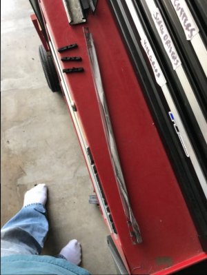

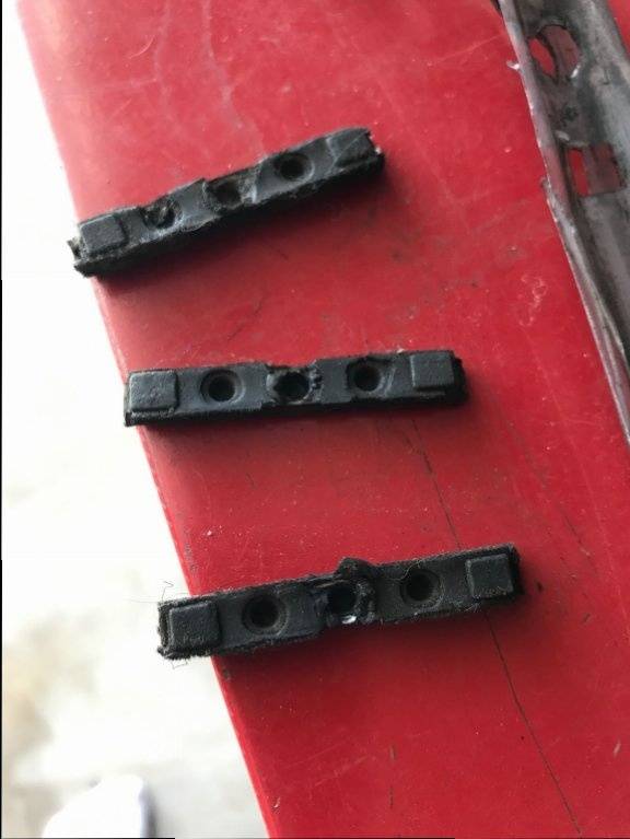

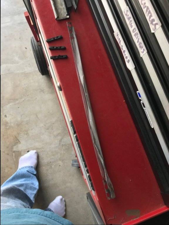

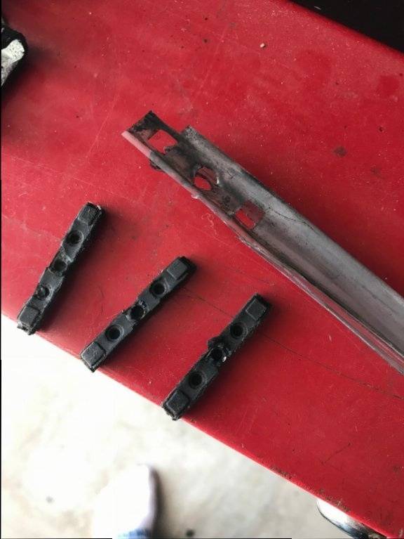

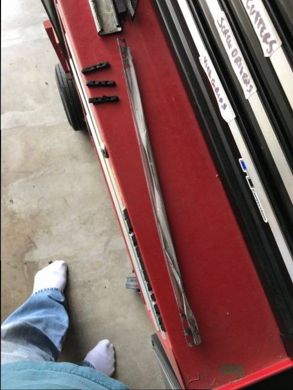

Can someone lead me in the direction of where I can find parts for this. My drivers side window is no longer connected to the inserts, looks like some sort of pin or pressure system with a plastic insert ??

The reproduction glass channel runs are very fragile and easily torn. You might also want to reuse the original "H" pins as the reproductions tend to be a bit oversize and wants to bind up. If your originals are cracked and no longer hold tightly, just hit the edge of the nylon pins with a file or sand paper and take a bit of the material away.
The reproduction glass channel runs are very fragile and easily torn. You might also want to reuse the original "H" pins as the reproductions tend to be a bit oversize and wants to bind up. If your originals are cracked and no longer hold tightly, just hit the edge of the nylon pins with a file or sand paper and take a bit of the material away.[/QUOTEGood to know, thanks 69bfan
