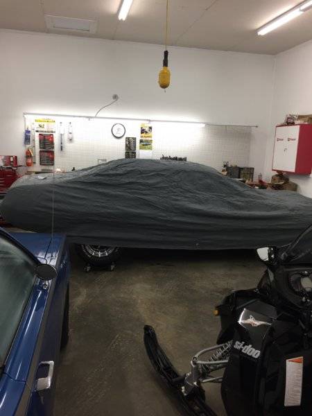

Hey I just bought a 71 RR clone in NC in January, nicely restored driver, had it trucked up to my garage in Ontario Canada where it has sat since. Drove it off the truck after idling for five minutes, parked it in the garage and shut it off. Its the dead of winter here, I haven't had a chance to start it up since. I'm only a hobby mechanic by necessity, fixing brakes and tune ups and whatever on our modern cars as needed. The RR is a 400 ci, freshly rebuilt. Should I periodically start and run it in the garage? Or should I let it hibernate and pull the plugs? Please let me know your thoughts, new to this :)
I’m not a fan of starting and let idle, if it’s not going to be driven just leave it. Prime the oil system before you start in spring. Do you mean pull the spark plugs? I wouldn’t, I want the engine sealed while stored. Cover it, wheels off the ground, either on rollers or jack stands. Full tank of gas... My .02

Thank you Al, Phil, Khrysler, and Coronet. The car was running "extensively" during maneuvers in early January, and garage does not drop below freezing. I'll consider getting the priming rod anyways though. Anti freeze has already been taken care of. For elevating under the suspension, axle in back and k frame in front?

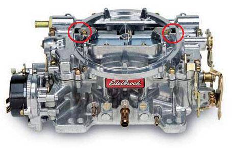

Oil is recent, but engine has been rebuilt recently also so I was going to change after taking it for a few laps in the spring, maybe 200-300 miles. What is used to prime the carb to fill the bowls? Just pumping the gas pedal?
Pumping the pedal won't do anything until the float bowls have gas in them.

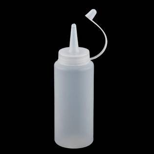

I just use a bottle like this.

Then give a good healthy squirt (about 1/4 of the bottle) into each of the float bowl vents.

BTW I'm putting jack stands underneath the k frame in front and the axle in the back to elevate all four tires
