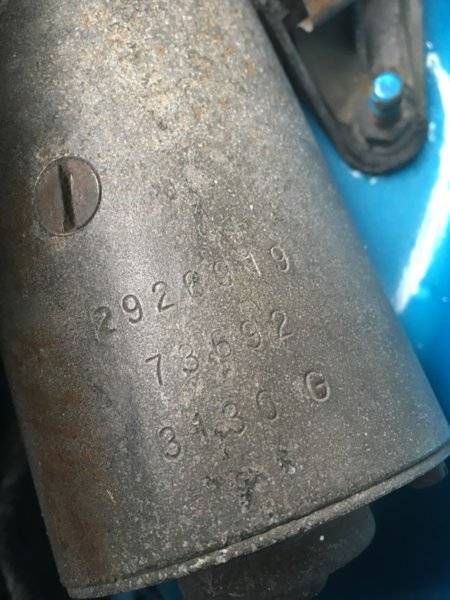

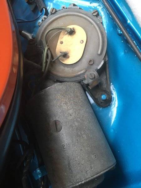

69 roadrunner, originally had a 2 speed wiper motor but the last owner swapped in a 3 speed when he installed the 6 bbl. I need to replace the motor, it's very week and it looks like crap anyway so I'm lookin for a source for a restored motor. At this point I'm leaning toward Bill Meerholts, please feel free to chime in on other possible sources.
Anyway, this is where it gets confusing, the motor that's on the car looks like a 71 but the pigtail (also a 4 speed car) is correct for a 69. I realize that could have been replaced but it doesn't look like it. Also to add to the confusion, I can't find a reference to this part number anywhere. Take a look at the pics for yourself but unless my eyes deceive me, it's 2926919.
What do I have here? As far as I know, the correct part number for the car would be 2983116, the car was built in December of 68.
OE guys, help me out
