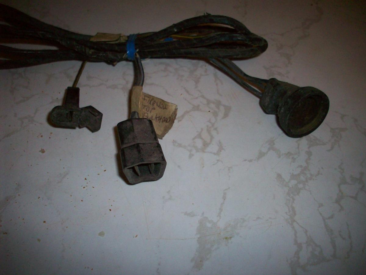

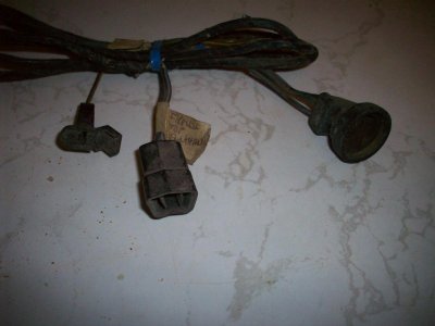

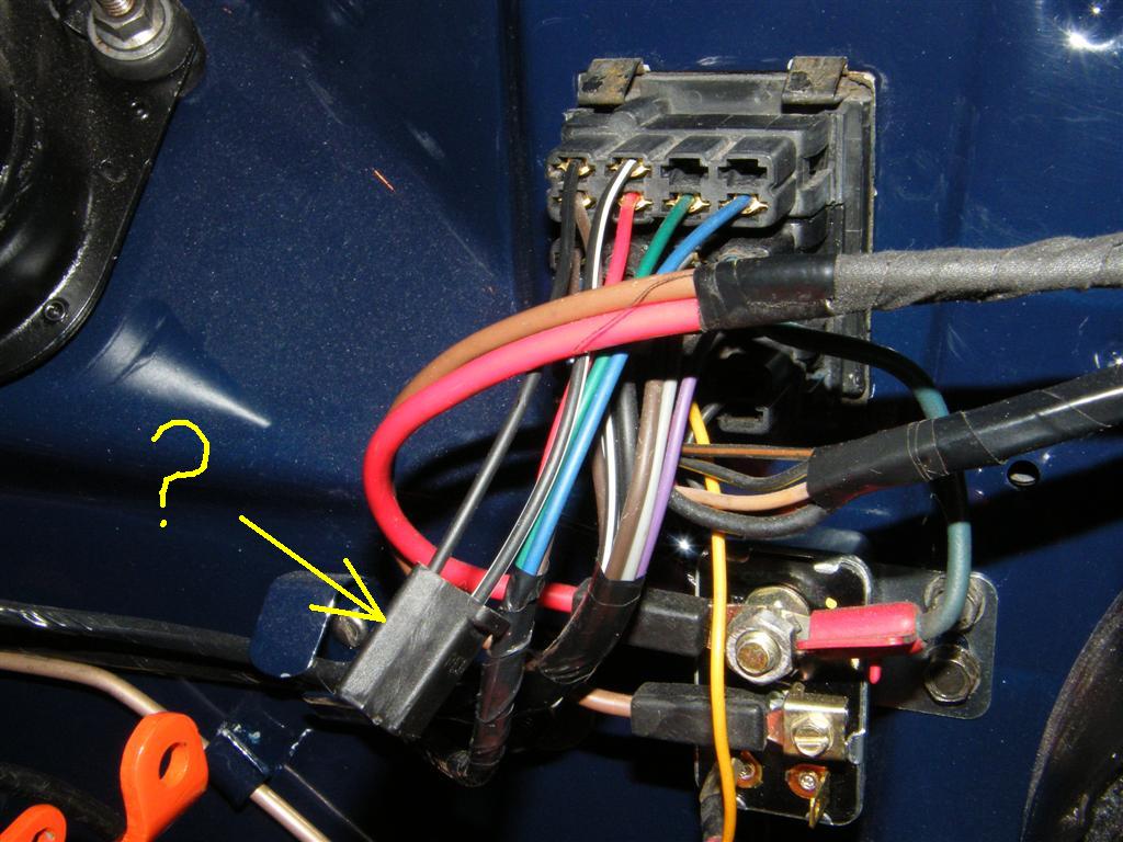

Got a 'loose end' I was was hoping someone could identify...
We got the new wiring loom for our 69 Sport Satellite that includes the wiper motor, but appear to have a spare connector (see yellow arrow in pic below).
We suspect it's for a motor with more speeds. Our switch on the dash is marked "OFF . HIGH" It's been a few years now since we used it so the memory's starting to fade, but i presume the . (dot) is ON, or LOW, plus the HIGH, makes ours a 2 speed.
So was there a 3 speed motor that uses an additional connnector?
Grateful for any advice :icon_salut:

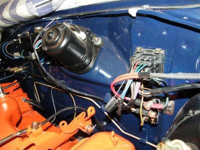

Its a four speed wire harness conector. It connects to a backup lamp switch for a manual and neutral start switch for a auto
Great info guys thanks. Sorry for the delay in replying - havent had much time on here this week, but much appreciated :icon_salut:
