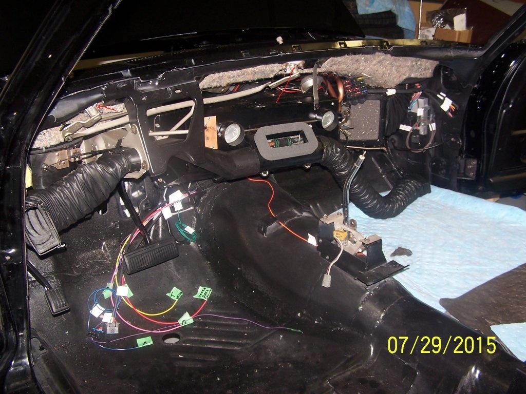

I installed zerks in my wiper posts because they were very dry and I didn't know how else to get grease in. For me, it was a one time thing as I don't have any idea how to get back up in there without pulling the dash. I used a synthetic grease that should last as long as the rest of the car. I had a supply of zerks from old scrapped tie rod ends. I just drilled a hole and used the threads on the zerk to tap their own threads. Here is a pic
