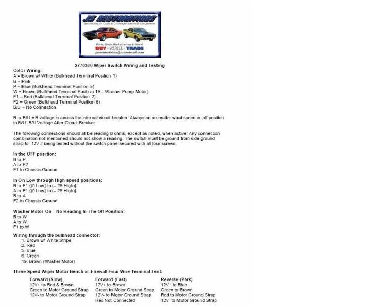

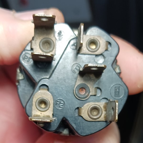

I have a Mopar # 2497282 single speed wiper switch I picked up. I want to bench test it before I hook it up to the car. I see some letters on the back of the switch next to the terminals but sure would like to see a diagram. Anyone have one or know where to find one? I did the old google search and didnt find anything
This may or may not help, however the web site may have more information there.
Hey the website address is difficult to see, can you post it? Thats for a different # switch but I sure would like to check out the site. Much appreciated!
Eyes are dulted from eye test and until later sight is still fuzzy, JS Restorations---retiring or Devin Duke of Wagoner OK from www.moparts.com
