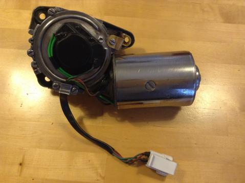

Hey
Wiper motor resto ready (73 charger/ motornumber 3431665
Variable 3 speed)
How can i test it ? I put ground wire with that brass grounder
And + red wire it works all time .how can i connect that works one round at time ?
This should help.

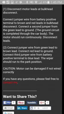

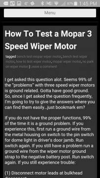

Google is your friend, use it!
Thanks, posted it with my phone and didn't realize how small and crappy it posted.
