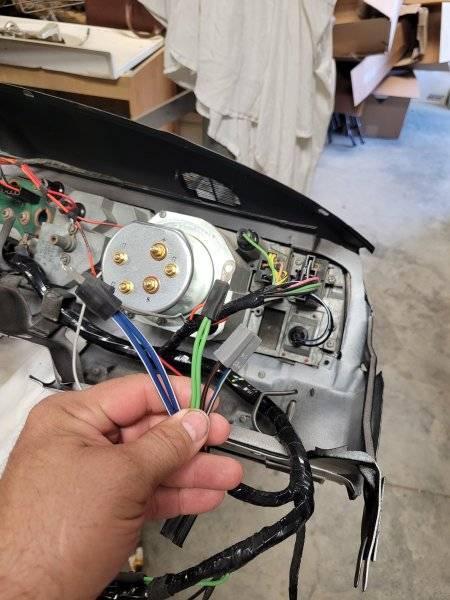

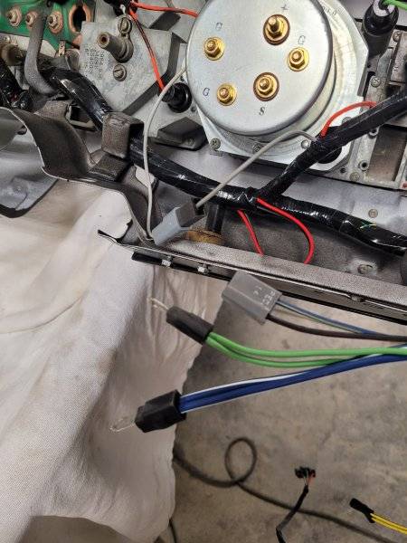

Can anyone tell me these wires go ? 70 roadrunner
Sorry not much help but never seen those on my 70 RR
Ok, thank you

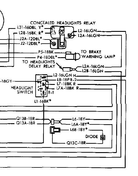

70 was first year for that but are those the ones? Maybe someone will post a schematic showing those colors in detail and we’ll both know. That’s a new under dash harness I take it?
Yes it is. And yep looks like for headlight relay
BTW, obviously those terminals would not be used on a Plymouth, the ring terminals will be live under some conditions, be sure they get insulated and secured.
