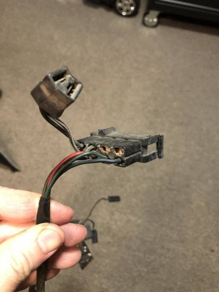

I was comparing the new wiper motor harness I bought to my old wiper harness and noticed that the old one has an extra plug on it, for the automatic transmission. My question is, which one is incorrect? The original looks pretty original. Where is the trans harness supposed to plug into?
You can move the old 2 wire plug to the same slots in the new harness.

I think the last two connector cavities are for (A - Dark Blue) A/C Clutch, and (B - Dark Green) Heater Fan motor?
Cavity C should be the black Reverse light switch return, Cavity D s/b Violet reverse light +12v power?

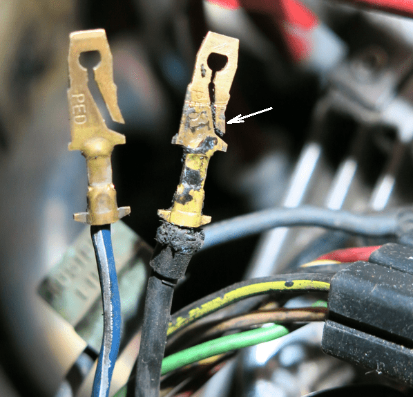

I think he wants to remove the male connectors? Depressing the tab with a small screw driver is for the female connectors.
You’re right, the word tab probably isn’t the right term for the prong on the side of the male terminal. But I do use a small screwdriver to remove both styles of terminal.

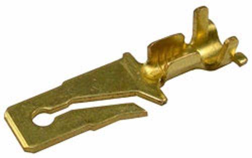

See the groove on top of the terminal? The terminal slides in from the rear, and "catches." You poke a small driver down in this slot from the front to release the tang/ finger / latch
I think the image will be self explanatory
the smaller "leg" its also the retainer on housing. Once bent will allow to be pulled out. Then expand it back before clip it into the new housing
