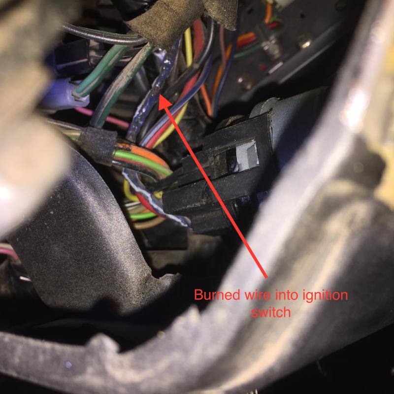

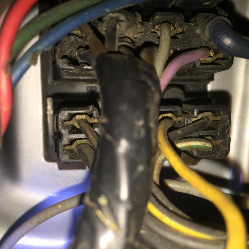

I recently discovered that I have at least two burned up wires/connections on my 68 GTX. The wiring looks to be all original to the car. On the engine side the connection is burned on the N plug of the bulkhead connector. That's a dark blue wire w/ tracer from the IGN side of the voltage regulator. The plug above may also be affected (N - brown wire to the washer fluid pump).

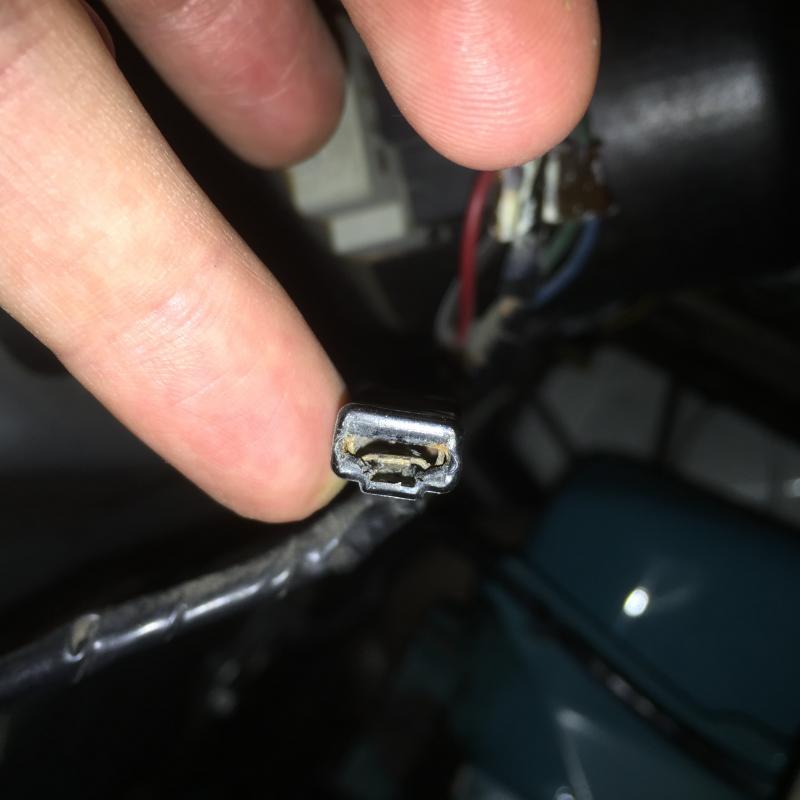

The connection inside the plug on the voltage regulator also looks like it could be burned a bit.

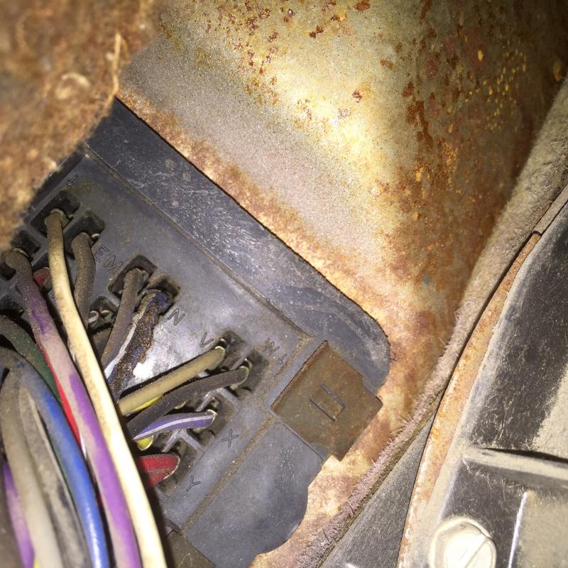

On the inside of the car, the connection at point N of the bulkhead also looks burned.
That wire (dark blue with tracer) looks to run from the bulkhead to the ignition switch and from there to the oil light in the dash. It looks to be burned all the way to the ignition switch and perhaps beyond that.

I couldn't download your attachments. Had a similar melt down before I did the ammeter bypass. Check mad electrical upgrades for this circuit change. I ran a #8 wire from the alternator to the starter relay including 6" of #12 fusible link wire. I replaced all the damaged wires and the female and male connectors in the bulkhead. The bulkhead unplugs from the firewall on the engine side and then the other side is removed from the car interior firewall. Can't remember where I got the individual male and female bulkhead connectors. Always solder and shrink wrap all connections. Hopefully this will help as I can't see your pics.

No need for a new harness. Melting is obviously cased by heat. heat is caused by either a short to ground(body) or by high resistance in the circuit (usually an poor terminal connection). The firewall terminals are poor at best. Add 40 years of corrosion and you get problems. The connectors can be sandblasted and filled with dielectric grease. If only a few cavity's are lightly damaged the connectors can be removed and a solid piece of wire run through the existing cavity ( you may have to run a drill bit through the cavity to clean it out. New Plastic hard shells are available . The good existing wires can be swapped and replacements fabricated for the damaged items. First you need to see what circuits are damaged. see wiring diagram here.

If damage is severe the firewall block can be removed and pulled back under the dash by depressing the clips and pushing it back through the inside of the car. Real bad damage may even necessitate dash harness removal. But you would have to do that if you were to replace it either way. Take your time. It's just like reading a road map. I just finished repairing my friends 68 Hemi RR.

I'd ditch the bulkhead connector altogether! They are known to cause problems but if your wanting to keep it original I'd at least replace it and lube it up with a good electrical grease (I use copper never seize). Removing the bad wires and drilling out the connector to let the wire pass threw is a decent cheap option but I would be concerned with the rest of them too. I wouldn't even think about cleaning them up and re-using them, once a terminal has gotten hot it looses it's spring (clamping ability) so your just asking for trouble. Good luck
