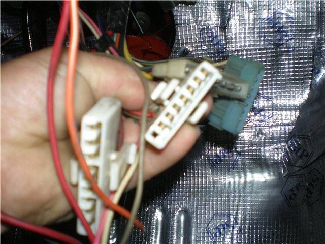

Help! I have 4 connector. Two of these is on the steering column.I don't know where connect other two white connector?
One of the white connectors coming from the steering will be the ignition, it is easy to tell, there will be a noticably bigger red wire and a big black wire.
The connector that has a point on one end will be the turn signal and horn connector.
I cannot really see the other two connectors, take a picture of the side if the connector, so we can see the wires and not head on.
