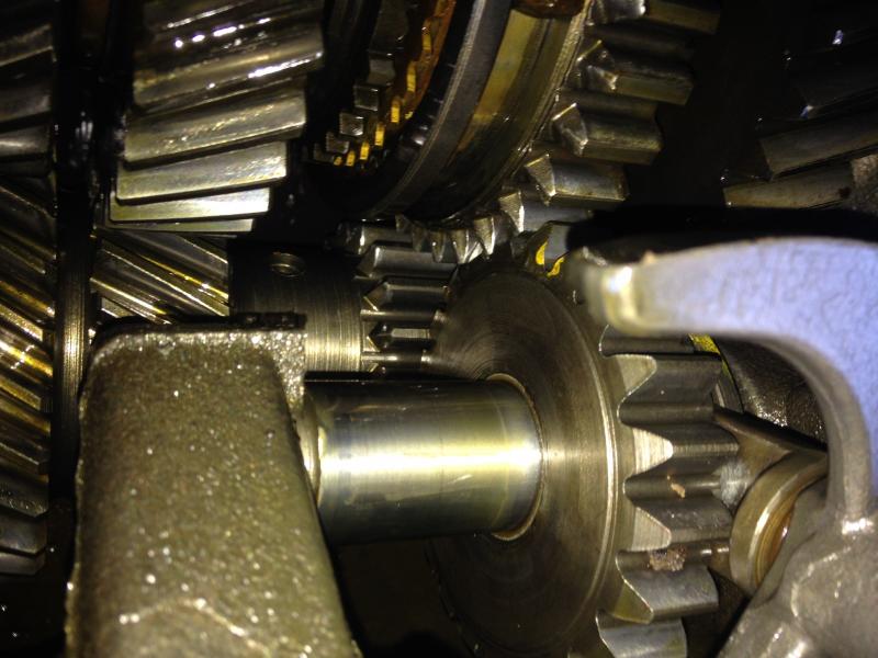

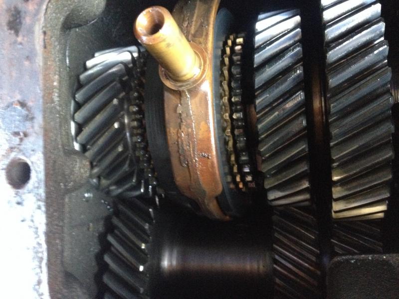

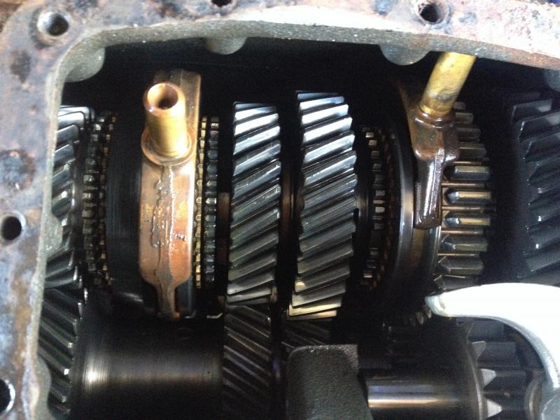

Well finally off work after another 12 days 10 hour days. Anyway I got time to pull the side cover and look around. No shavings no worn teeth goes in an out of gear great. Spins nice no noise. Few questions. First is the marks on the gear in yellow something the factory would have put on there? Also would or did they use rtv between of the tail shaft housing and main body?

Looks good inside, for beeing subject to allot of water
Sorry I'm not enough of an expert to say if that's factory or not,
I'd suspect the yellow mark on the gears are,
BUT; I think {don't quote me on either}
there was a paper gasket between the tail-shaft housing & the main body from the factory...
maybe someone else will know for a fact
call Brewers or Passon Performance they'd know for sure
Thanks bud nicks. It has not been subject to water when I say it has surface rust from sitting in the Weather I mean in a carport just not covered with anything. It's actually cleaning up well and I'm learning so much about these as I research. I'll end up taking it to a trans shop to 100% verify but right now I may end up using it.
good luck, thanks for a clarification
Budnicks is correct. There was a paper gasket between the tail-shaft housing & the main body from the factory. Don't be afraid to dive in and have a crack at this yourself. I just got done over hauling mine about 2mo ago. Follow the service manual step for step and have Brewers phone# handy and you will do just fine.
