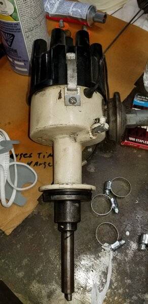

Would this dual point be a good distributor to have rebuilt and run?

It looks like a late 60's dual point is there still a tag on it?

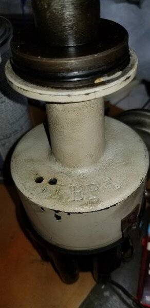

Thats just a casting number, can be anything from a 273-440. See if you can figure out which one then it is a crap shoot to what the curve is without taking it apart and measuring the camplate etc. looks like a B/RB by the position of the Vac advance.
Measure the shaft from the base to the end! That will tell if it's an RB,B Block, or a small block!
My 67 R/T had one of those from the factory. They are a real pain in the backside to set and adjust. After messing with it for years, and having it re-bushed at the machine shop, I finally did the best thing ever for the car's ignition. Took it out and installed a Mopar Performance Electronic Ignition kit with a new distributor.
The newer electronic versions are easier to deal with and stay constant compared to any points stuff. Just say'n.
Mopar Distributor identification guide by measuring shaft length, measured from mounting surface to lower end of distributor shaft.
Mopar LA engine – 3.875”
Mopar B engine – 3.5″
Mopar RB engine – 4″
Chrysler 331/354 Hemi – 4.25″
Chrysler 392 Hemi – 4.5″
Dodge 241/260/270 Hemi – 3.875”
Dodge 315/325 Hemi – 4.25″
Desoto 276/291 Hemi – 4.00″
BTW a good dual point distributer can perform very well. They just take maintenance.
IMO....I concur with Halifaxhops' a observation and add the following comment.....later years, 1968 and later, use a O-ring to seal the distributor body to the block, which this unit has. Earlier distributors used a thin raised bead copper crush washer to seal to the block.....very ineffective.
