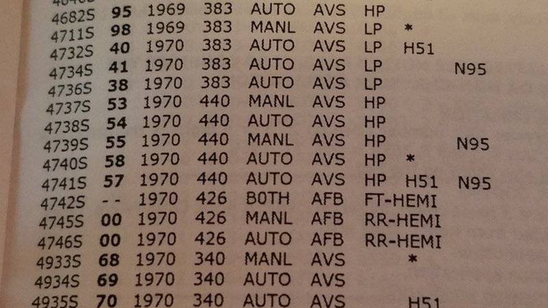

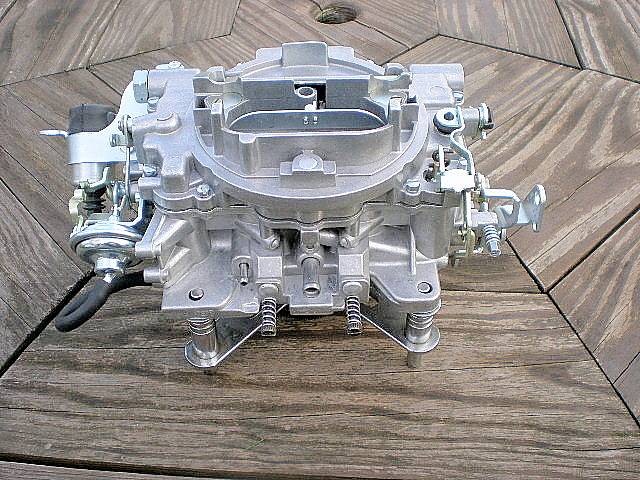

What is the correct AVS carb for my Feb/1970 built, 440 auto, non a/c GTX?
Any input greatly appreciated
Thanks, Bill

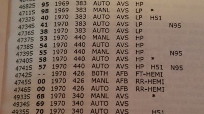

http://www.mymopar.com/carbguide.htm
4737 C-4-AVS 440 M/T
4738 C-4-AVS 440 A/T
4739 C-4-AVS 440 M/T (California - ECS)
4740 C-4-AVS 440 A/T (California - ECS)
4741 C-4-AVS 440 A/T & A/C
edited corrected numbers.
#4737-4741
Might have screwed up the number when I copied it over I had to do it column by column. Might have grabbed that 4736 by accident but that’s why I posted the link also.
