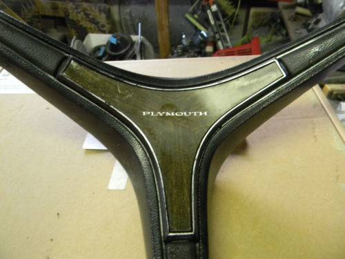

I bought a 1971 Steering wheel for my RR, problem is the steering wheel says Dodge. Couldn't find a steering wheel with word Plymouth on it as in the attached picture. I found a few online, but the rear retention clips were broken off.

you can also pull out the center finish from the one with the broken pin and install it on the wheel you have with the Dodge lettering. That's a chromed layer stickied to the center plastic piece
needs to be made with care but is doable. You can try it on the Dodge one you have at this moment. I think some glue solvent like gasoil or gasoline will help to get softened the glue while prying it up... or a heat gun?
( actually this center trim is in AWESOME conditions but the broken pin )

I looked at those on EBay previously. Perhaps I can remove the dodge portion and swap with the Plymouth portion, never thought of that. Thank you
Being you actually need the Plymouth one, you can also simply BREAK the black plastic section from the ebay one with the pin broken ( you won't be using it anyway ) removing piece by piece while keeping safe the center layer trim ( maybe a cut disc and dremmel will help to cut the piece on sections ), and pry up the Dodge one without any care from the wheel you have... althought if you get it out in good conditions, can get some investment back trying to sell it for those don't like the decal option offered.

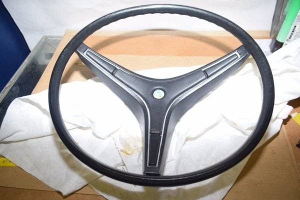

I am thoroughly confused now. I have upper left steering wheel in your brochure picture, on my shelf. I have the lower left pictured steering wheel on my car, and I just bought the upper middle pictured steering wheel. If I have a 71 RR, which wheel is the actual one? I was under the impression the middle upper center pictured steering wheel with the Plymouth wording in the middle of it was the correct wheel.......

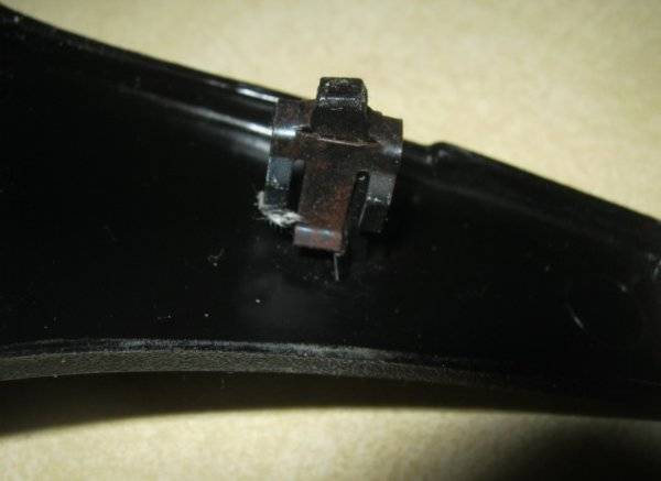

Do you know why that these are so common to have broken mounting tabs? Because people don't have PATIENCE!!
You need a heat gun or blow dryer and WD-40. Heat up the plastic with care not to get it too hot and damage the wood grain insert. Slightly pry up on the end and take a WD-40 can with a snorkel straw and drench accordingly. Take your time using a stiff plastic putty knife (same as the door panel tools) prying it slowly. First one's always the toughest. I removed at least a half dozen of these w/o breaking one tab.
That's 40+ y/o hard plastic there. Plus the metal clip being very dry and maybe some rust spots. No wonder these break upon being pried out w/o precautions.
Tip: Use the eBay listing pics to gauge where the mounting tabs are located to give you an ideal where to pry instead of doing it blind. Below is a close-up of one of the mounting tabs/clips. I do not have this steering wheel center anymore as I already sold it.

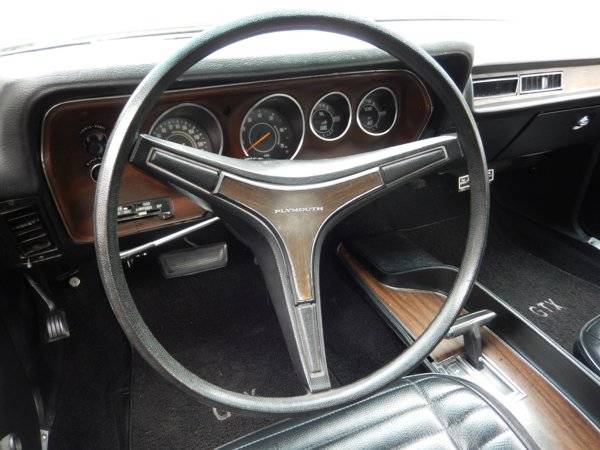

The steering wheel the guy posted in the first picture , is the one you want for your car, you just pop the center out and put in the plymouth center piece, same as mine, all 71 gtx say plymouth in the steering wheels, options
