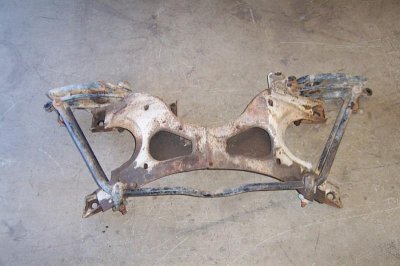

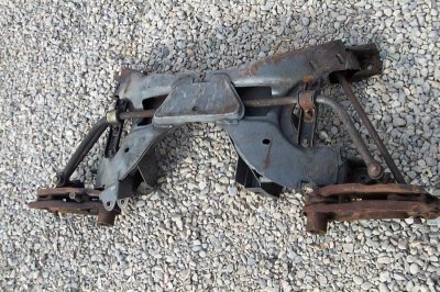

70 has the swaybar through the k-member, 66-69 is in the front of the k-member.
All you need are the big block motor mount brackets to stick in a BB onto a SB K member....but like mentioned, if it came with a small block, a big block will fit, as long as you have the right block brackets and they are not hard to find.
Top one is the 66-69 Style
Bottom is 70-2 style.
70 has a diiferent steering box angle than 71 making it a one year only frame.
