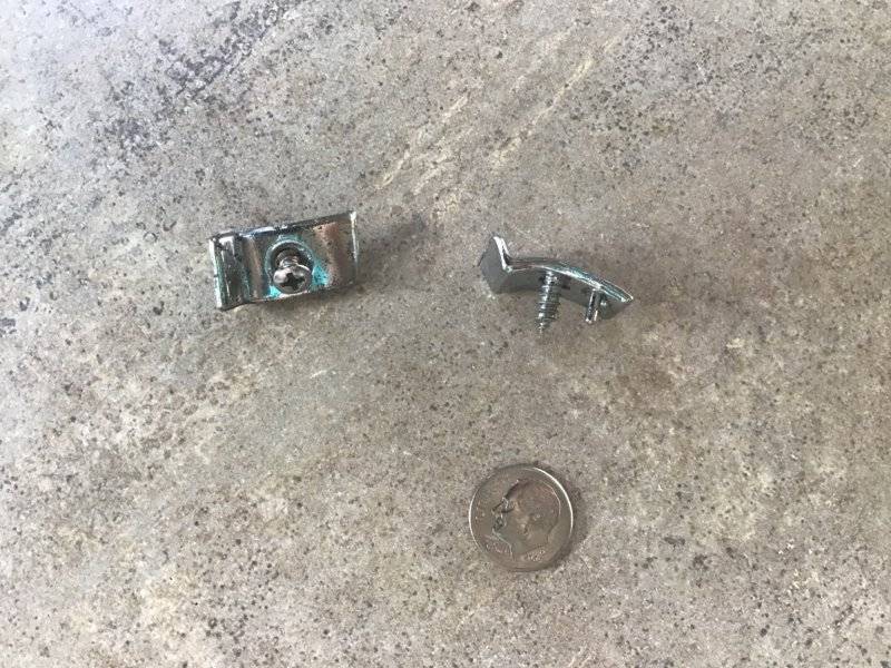

The vinyl top would have a small chrome trim piece at the top of the A Pillar to cover the end of the vinyl. There would be 2 holes each side, screw hole and the locator pin.

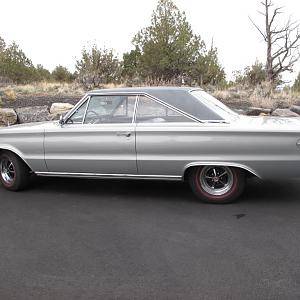

Thanks for your help. I also found another source called SMS Auto Fabrics in Canby, OR. They are sending me a sample of the material along with a quote. I can keep in touch once it arrives and let you know what I think if you would like. I did look at Legendary, but honestly I'm a little put off by the price = $952! I have attached a photo of a car that has the Y5 coded silver vinyl top.
