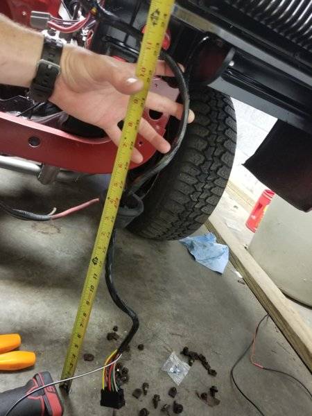

I've been slowly getting my 66 Charger back together and I ran into an interesting problem
I bought the engine & headlight harness from YearOne
Under hood harness installed just fine but the headlight harness seems to be about 18 inches too long. When compared to the original harness the connector if about 4 inches from the core support grommet but the new harness is much longer. about 18 inches too long. I had to double it over and zip-tie the extra it under the battery support.
Has anyone else run into this problem?
if so, what did you do?

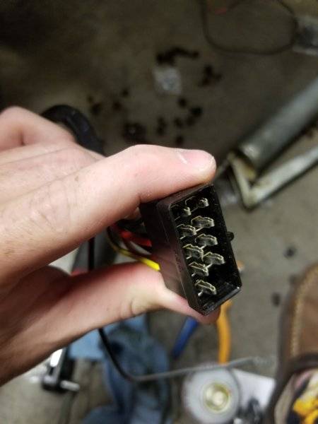

I am mostly just trying to get me the pins so I can cut the wires off crimp new ends on and repin the connector

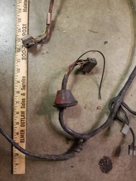

Original harness end was 10.5 inches from the Y
New harness is 21 inches from the Y

No original tags but as I pointed out to them. Their engine harness is the exact length of my old one. The connector is in the same place the old one was. The length of the light harness is the issue. There is no way to connect the two harnesses without looping the light harness up under the battery tray.
They have agreed to send me the wire ends so that I can shorten the light harness myself
As far as I am concerned, this is a happy ending and I was treated fairly.
This post is in case someone else runs into the same problem
