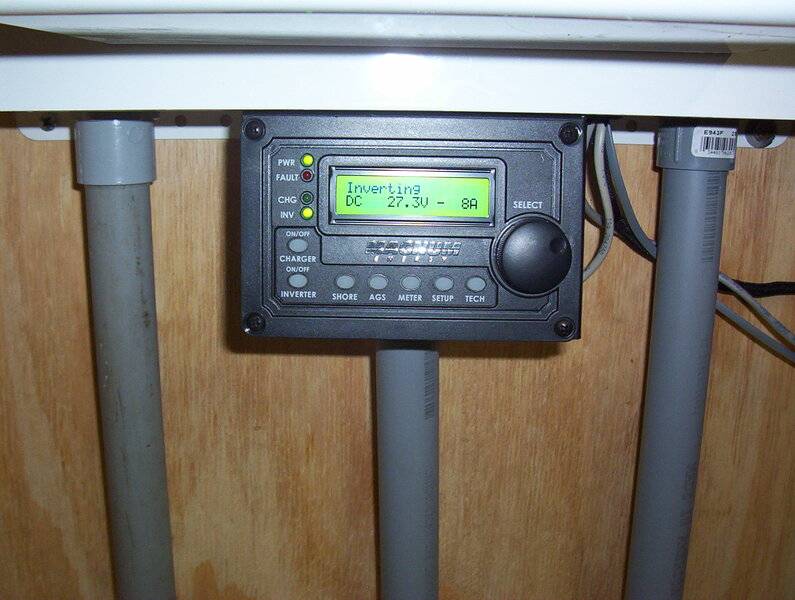

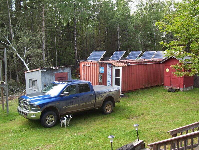

While my system is totally off grid at my hunting camp so one can not compare with grid tie. However I wish I would of done this a long time ago. Right now my generator has not run since 9-4. I have 6 310 watt panels and a 4,000 watt 120volt inverter. I do have 4 AGM solar design 6 volt batteries in series for 24 volts. I need to remove more trees. If I was younger I would do a properly designed residential system for the home and shop. Here are some pics.
100_2560.JPG 100_2550.JPG 100_2562.JPG 100_2564.JPG 100_2563.JPG 100_2565.JPG 100_2566.JPG
