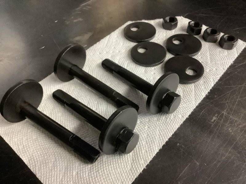

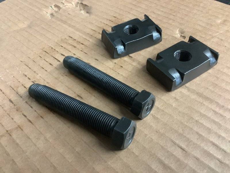

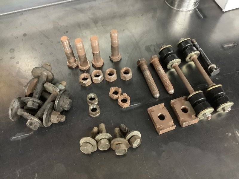

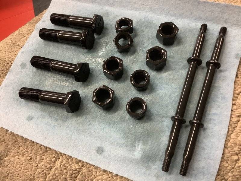

Done at home with Caswell black oxide, it's not difficult or terribly time consuming. Before and after photos...

That looks great. What did you do to prep the hardware? Sand blast?
I wire brushed everything on a bench grinder because that’s what I had.
After wire brushing the parts were soaked in acetone to degrease. They were dried with compressed air after soaking, latex gloves were worn to avoid contamination from body oils.
Once dry the parts were placed in a mix of the Caswell product and distilled water, IIRC the ratio was 1 part of the chemical to 8 parts distilled water.
After soaking for 3 to 4 minutes in the mixture, the parts were removed and placed in straight distilled water to neutralize the chemical, then dried with compressed air.
The final step was to place everything on a paper towel and spray with generous amounts of penetrating oil, I let the parts sit for several minutes to allow the oil to soak in. Excess oil was wiped off with a dry paper towel.
At that point, the parts are ready to use…
